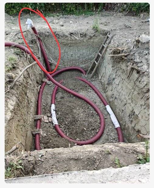

Hello,
I'm working on my greenhouse project in my back yard.
For heating over winter I'm experimenting with earth tubing, so I buried 160ft long pipe (5" in diameter) 9ft underground. Yesterday I called friend that has camera for sewer inspection and we run on a problem. Somewhere on 80ft of pipe, we found water that is blocking airflow, water is approximately 9ft underground (on lower layer of pipe snake).
Is it possible to drain(suck) water from that pipe?
Pipe was put as snake in that trench in two levels, on image is second(upper) level, first(lower) level is same as second. There are no 90 or smaller degree turns, I did try to make turns as wider as it can be.
Thx :smile:

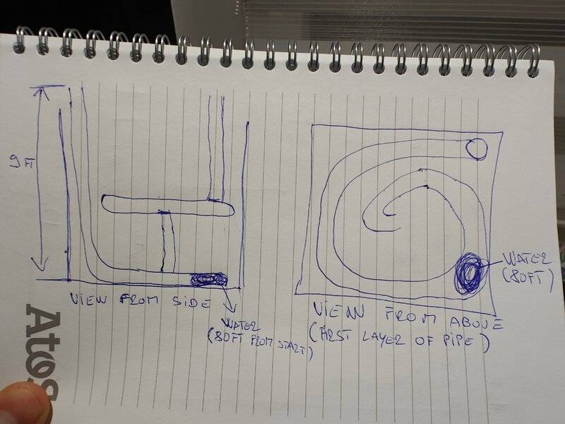

I need a diagram showing the level throughout your system before I can answer that question. Pipes are usually laid with a constant slope, so they will drain by flowing downhill to an outlet. If there is a low point, called a sump, you may need to put in a vertical access pipe or a shaft. A raised portion, with a sump on either side, is called a siphon.
Let us see your diagram showing the depth levels.

I don't have diagram.
I can only provide image and tell you on what depth and how far from the opening of pipe is water.
On image below i marked opening on pipe where I will enter pipe. From that point, pipe goes straight to ground for 9ft and then pipe is layed like snake (like on the image).
I hope my drawing (second image) helps a bit :rolleyes:
Have you filled in the hole yet?
Lay the pipe so it spirals continuously upwards from one end. The water will then flow down the spiral and collect at the lowest end, where you can reach it easily. You might install a permanent vertical pipe above the lowest point, for pulling out water when needed.

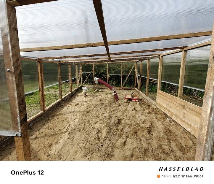

Yes, and I already made greenhouse on top of it :rolleyes:
This image is 3-4 weeks old, I already closed all openings with wooden boards (like on the right side of image) and made half of the raised beds.
OK, so feed a 1/2" or 3/4" poly-pipe into the 5" pipe, keep feeding it in until you can suck out the water. Let the small pipe remain in place for use next time.

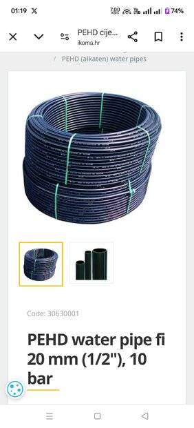

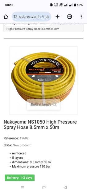

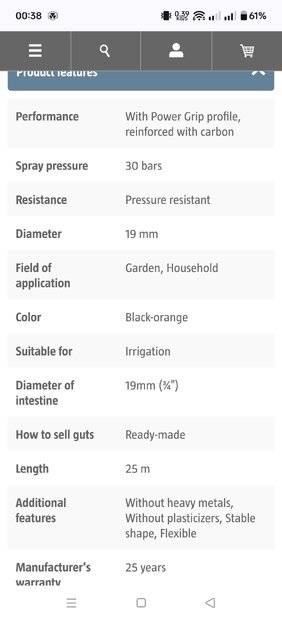

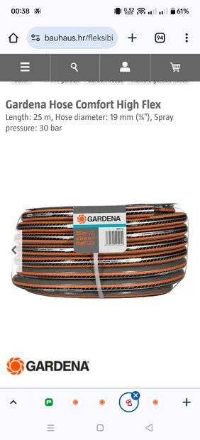

Do I need some special poly-pipe for high pressure or garden one will be good?
I found this one here in Croatia (image below), but it's only 8.5mm in diameter.
High pressure hose
Regular hose (reinforced with carbon threads)
I would use the black polypropylene pipe that has a solid hard wall and is used for irrigation. You will find that is slippery and sufficiently rigid, that it can be pushed into and along the 5" pipe. It comes in 100 m rolls, and will cost less than any flexible hose.
Likes druidhr

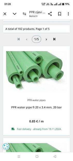

I can't find polypropylene pipe here in Croatia. Are those PPR, PEHD or PEX pipes.
HDPE is a possibility. High density is required, avoid LDPE or MDPE as it is too soft and flexible. Either HDPE or polypropylene is suitable.
It is very low cost and usually has green (irrigation water), or blue (potable water) stripes extruded in the black pipe wall. The pipe needs a thick hard wall, so it will not collapse when subjected to a partial vacuum, and so it can be pushed along the other pipe.
Google search for: rural green poly pipe

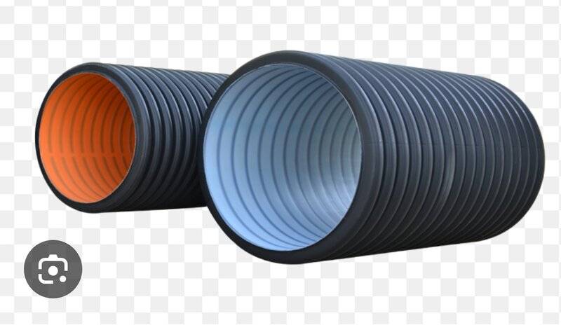

Is the 5" pipe rated for 15 psi external pressure? It may collapse under the hydrostatic pressure of wet soil, 9 feet below the greenhouse.

Yea, I bought special double wall couagurated pipe that are designed to be buried directly into the ground. They have wide range of applications, here in Croatia optical fibre cables are pulled through (you know optical cables are very sensitive lateral bending)

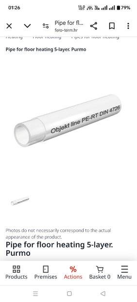

Yes, if air fails as heat extractor, I could pull 1/2" HDPE pipe through 5" pipe and fill it with water.

It should be worth while filling the outer pipe with water - both for good thermal contact with where the heat is transferred from and to and for thermal capacity. On that topic, if you want good heat transfer on hot days, you would benefit from a number of heat exchangers above ground. That would make the best of any available heat and reduce unwanted leakage at night. I mean a sort of thermal ratchet. A simple (CH ) pump could control heat transfer by using a thermostat.
