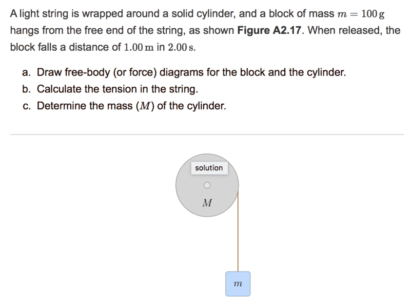

Thank you, i got 4 but another friend of mine got 7? Do you know if my math is right?
For the picture I attached I got the answers to be T= 0.93 N
I got the mass of cylinder to be 3.72 kg..
Does that seem right? Furthermore, for the FBD for the block it should only be Tension upwards and weight downwards? And then the cylinder should have both tension and weight downwards? Does that make sense?
Thank you again!
Thank you again!
So the cylinder turns and has a moment of inertia. Do you know how to handle those type of problems?
Likes jfnn
Yup. I got the mass from that moment of inertia using torque = I * the angular acceleration.
Do you know how the free body diagram should look for the cylinder? Is it tension and weight pointing down?
OK. Yes tension is down, weight is down, and reaction force at the axle is up.
Thank you so much. Did you happen to get the same tension and mass by any chance? Some reassurance would be awesome. LOL
I also came up with 4 m/s.
I arrived at the same values for the tension and the cylinder mass. I wasn't sure if you need to know the radius, but it turns out that the radii cancel, so two cylinders of vastly different size but the same mass (say one made of styrofoam and the other made of lead) would allow the falling mass to behave the same.
Thank you so much! I thought the same thing as you, which is very interesting!
