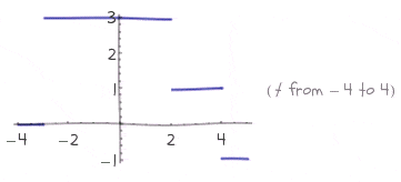

Both of graph is plotted using wolframalpha, for the u-functions :
y(t)=3u(t+3)-2u(t-2)-2u(t-4)
The 3u(t+3) function is correct, but for -2u(t-4), i think it should have a line starts from (2;-2) but the graph only shows a line starts from (4;-1), and where is the line for -2u(t-2). Where does the line start from (2;1) to (4;1) come from ?

Wolfram alpha would be good for checking your work, but you should first try to do the graphs manually.
Why would you think that? The function -2u(t-4) "activates" at t=4.
(4,-1) is correct.
That would be from the third time interval (I3), below:
Realize that y(t)=3u(t+3)-2u(t-2)-2u(t-4) is composed of 4 time intervals:
I1: -∞ < t < -3 [nothing is happening because no u-function is "active" --for amplitude, think 0]
I2: -3 <= t < 2 [3u(t+3) is the only "active" --for amplitude, think 3]
I3: 2 <= t < 4, [3u(t+3) AND -2u(t-2) are both "active" --for amplitude, think 3-2]
I4: 4 <= t < ∞, [3u(t+3) AND -2u(t-2) AND -2u(t-4) are all "active" --for amplitude, think 3-2-2 ]
In the definition of unit step function, the function-2u(t-4) should be
-2 if t-4>0 and 0 if t-4<0
so it should start from (4;-2), am I right ?
Yes. Technically its: -2 if t-4 >= 0 and 0 if t-4 < 0
