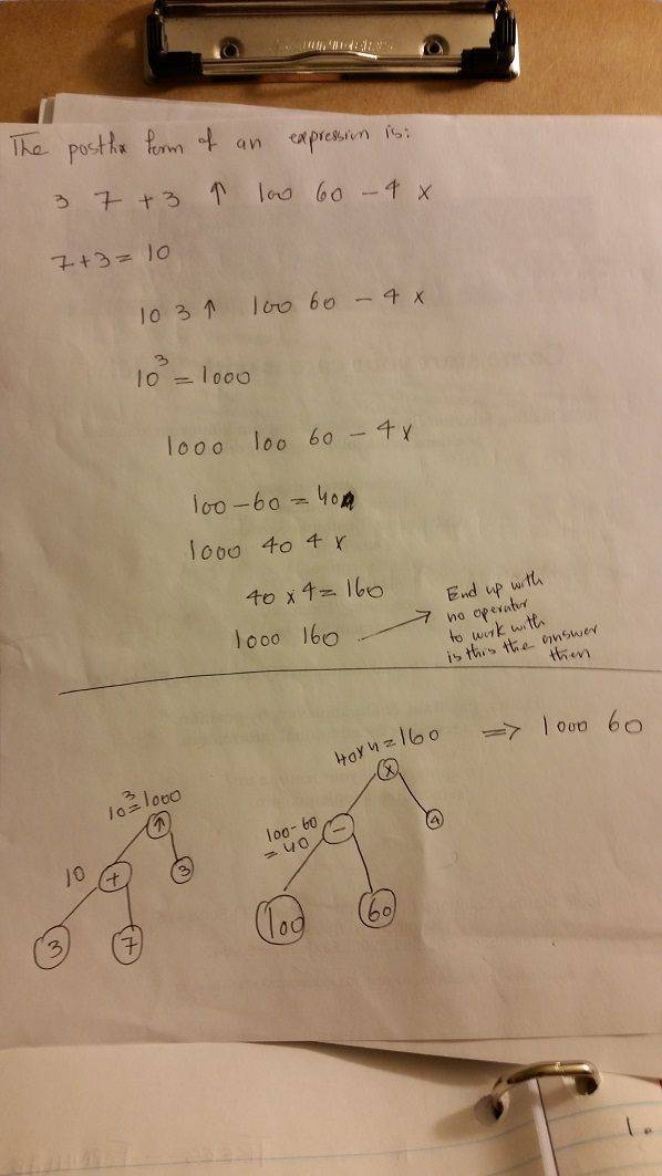

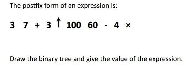

Drawing and finding the value of postfix expression
In summary, the conversation discusses the ending of a problem with no operator and the resulting nodes of 1000 and 160. The speaker also confirms the correctness of their drawn Binary Tree.
yakin
42
I am ending with no operator in the end. So 1000 160 would be the answer or what. I do not know what to do from here. Please help!

yakin said:
https://www.physicsforums.com/attachments/2472
https://www.physicsforums.com/attachments/2473
Yes you end up short one operator, so you have nodes containing 1000 and 160 with no operator to join them.
So 1000 and 160 is the answer. And did I draw the Binary Tree right?
Yes and yes.
