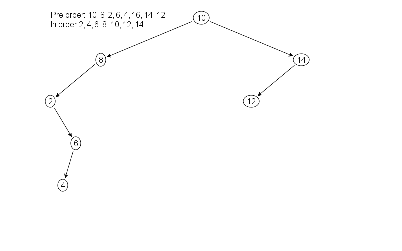

I am looking at the following exercise:
It is given a binary tree with 8 nodes and keys 2,4,6,8,10,12,14,16.The in-order tree traversal gives this order: 2,4,6,8,10,12,14,16.
The pre-order traversal gives the order: 10,8,2,6,4,16,14,12. Draw the tree. Explain how you drawed it.
That's what I have tried:
In a pre-order sequence, the leftmost element is the root of the tree.
By searching the root in the in-order sequence, we can find which elements are on the left side of the root, in the left subtree and which are on the right side of the root, in the right subtree. Could you tell me if it is right? (Thinking)

Hey! (Wave)
I believe the in-order of that tree is: 2, 8, 4, 6, 10, 14, 16, 12... but that is not what was given! (Worried)
You know the root is 10. Now find 10 in the in order sequence. You then know the left subtree has nodes 2,4,6,8 and the right has 12,14. Do it again. The left subtree has root 8. Find 8 in the inorder sequence 2,4,6,8. So you know the left sub tree from 8 has nodes 2,4,6 and the right subtree from 8 is empty. Continue.
It's a standard easy exercise to formalize the above and write a recursive algorithm to construct a binary tree given the in order and pre order sequences. I suggest writing such.

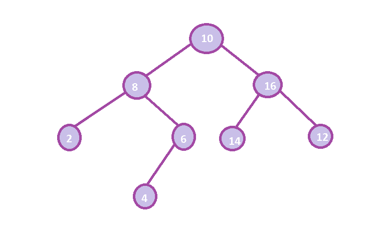

So, is this the binary tree? (Thinking)

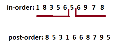

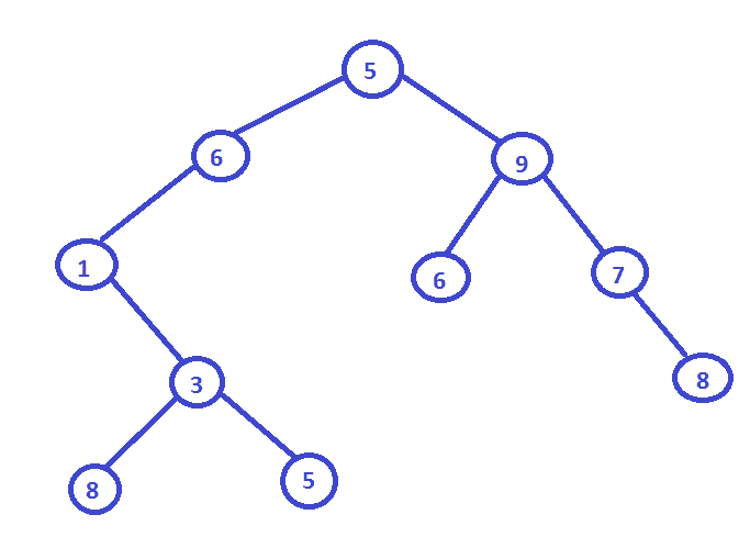

How about a tree with post-order 8 5 3 1 6 6 8 7 9 5, and in-order 1 8 3 5 6 5 6 9 7 8? (Wondering)
I like Serena said:
Yep! That's it! Good! (Nod)

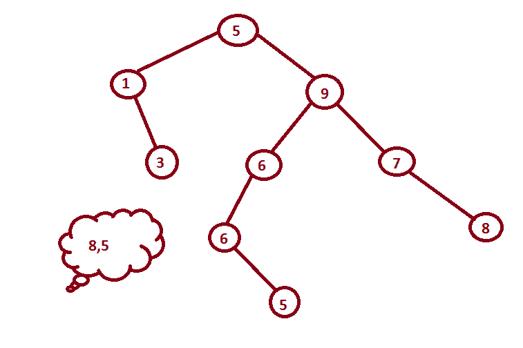

Is this one possible tree? (Thinking)
https://www.physicsforums.com/attachments/3617
Yep!
And I believe it's the only one! (Party)
I like Serena said:
Yep!
Nice! (Happy) So, couldn't we consider that the root $5$ corresponds to the $5$ of the $4^{th}$ position from the in-order traversal? (Thinking)
Huh? (Wondering)
I like Serena said:
Huh? (Wondering)

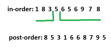

We know that $5$ is the root and so we found it at the in-order to see which of the elements are at the left subtree and which of the right, like that:
But, there is two times the number $5$.
So, couldn't we also do it like that? (Thinking)
Maybe.
Can we? (Wondering) (Thinking) (Sweating)
I like Serena said:
Maybe.

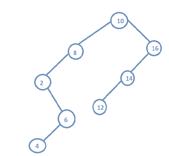

I think that we can't do this, because then it will be like that:
We will have to put the number $5$ but there isn't one left... Or am I wrong? (Thinking)
https://www.physicsforums.com/attachments/3621
I believe you're quite right. (Mmm)
We won't be able to fit in the numbers that are left in the thought balloon. (Angry)
