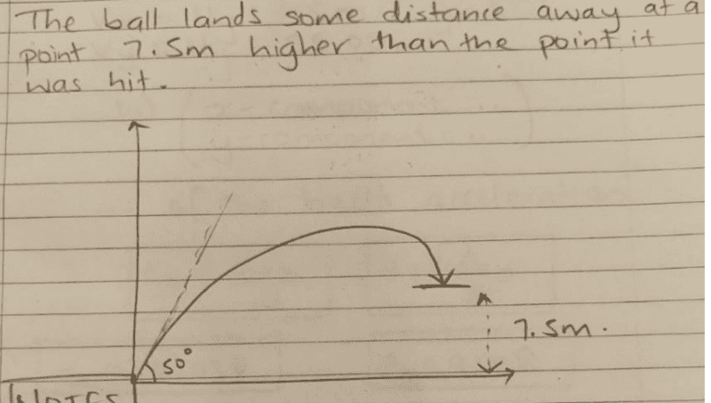

TL;DR Summary: I have a hard time doing well in physics questions from my undergraduate course. The reason for this is because I don't understand how to draw the motions of the objects in diagrams. Basically, I'm terrible at diagram making and visualisation of events that occur within a physics questions. Some guides on how to draw diagrams in different topic parts of physics would be amazing help! Thank you, everyone!
Hello everyone,
So I started off my third year of studying BSc Mathematics and Physics with Open University in October, 2023.
It's been quite difficult but I'm getting used to it. I don't mind the simple part of it which is mainly using formulations. Though, I'll admit, that too requires work. The straightforward part of the revision is also possible with regular reading of the notes. Still, any guidance on how to better remember the notes on different topics and revise physics would be much appreciated.
The focus of this thread is the huge problem I have when doing physics calculations and questions that require me to visualise the physics happening in particular questions. I tend to have trouble with reasoning out the steps of a physics problem too. However, I thought that the main issue was not knowing the correct diagram drawing skills in different topic parts of physics.

I am curious where you are having trouble with drawing. Not sure we can advise you well without a visual aid. Can you upload a pic of some examples you've drawn?

Could you show us one or two of those difficult diagrams that you have tried?
The first diagram above is on projectile motion and the one below it is on collisions.

I think I didn't understand the physics well enough to get it right in the after the collision diagram. I think that the underlying issue about not drawing the diagrams properly is that I'm not understanding the physics properly or well enough. Hence why I asked if anyone has some suggestions for studying physics well.
I mention this because I thought about your question and I noticed that the after collision diagram should have included the two particles sticking together and going off or something else I haven't figured out yet.

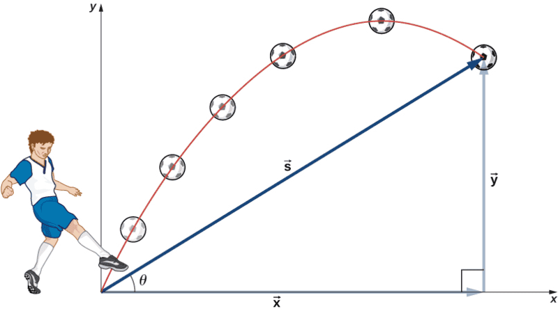

One tip about projectile motion problems (if air resistance is negligible) -- the motion of the projectile is an inverted parabola. This is because the horizontal motion is at a constant velocity, and the vertical motion is due to the constant acceleration of gravity downward.
So any time you draw a sketch of a projectile motion problem like that, try to make the arc in the form of an inverted parabola and remember why it has that shape. That will help you to formulate the equations needed to solve for whatever is being asked of you in the problem (like finding that 2nd point in the diagram where the projectile lands above the height that it started at). :smile:
https://courses.lumenlearning.com/suny-osuniversityphysics/chapter/4-3-projectile-motion/
