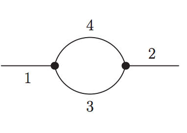

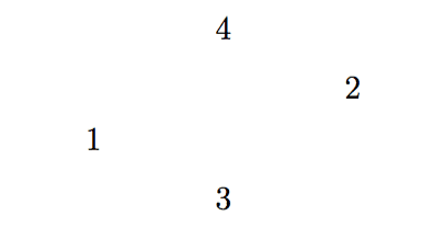

I'm trying to draw Feynman diagrams with the feynarts.sty package for LaTex. The problem is that if I write the following code

I get this

instead of this
how can I fix this?
How did you compile the file and what output did you look at?
I found the solution. I need to compile following the latex -> dvips -> ps2pdf sequence. This can be made in TexShop putting the command
%!TEX TS-program = latex
in the first line of the tex file.
