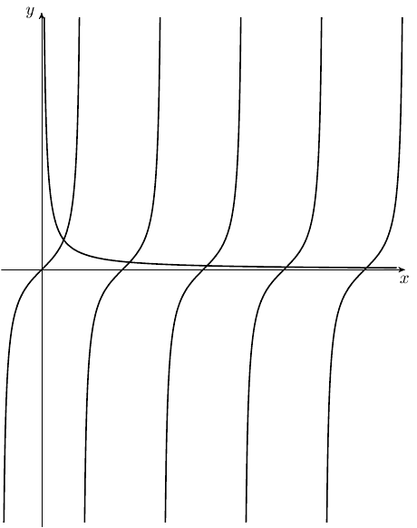

Code:
 \usetikzlibrary{arrows}
  \begin{tikzpicture}[>=stealth',x=.5cm,y=.5cm]
 \def\npi{3.1416}
 \def\periods{4}
 \draw[->] (-\npi/2,0) -- ({(\periods+.5)*\npi},0) node[below] {$x$};
 \draw[->] (0,-10) -- (0,10) node[left] {$y$};
 \clip (-\npi/2,-9.8) rectangle ({(\periods+.5)*\npi},9.8);
 \draw[thick,domain=0.05:{(\periods+.4)*\npi},samples=300,smooth] plot (\x,1/\x);
 \foreach \n in {0,...,4}
 \draw[thick,shift={(\npi*\n,0)},domain=-\npi/2+.1:\npi/2-.1,samples=100,smooth] plot (\x,{tan(\x r)});
 \end{tikzpicture}
gives
For a better quality, it may make sense to use gnuplot to compute the coordinates as described in the TikZ manual.

Is there a command to tell it to label every pi/2 on the graph?
