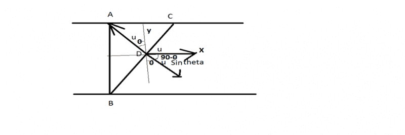

It was river swimmer problem.
A man and river are moving with same velocity u..A person is at point B initially.His velocity with respect to river is always towards point A.River has velocity in horizontal direction.So that person's path is shown as BC.At one instant D I have shown person's velocity withg respect to river as u and component of river's velocity as u Sin theta.
{cos (90-theta) =sin theta.}
So my teacher said that velocity of approach of person towards B is u-u sin theta.
This is correct picture of my river swimmer problem.
I assume you mean that the man moves with speed u with respect to the river, and the river moves with speed u with respect to the ground.
I assume the river moves to the right, call it the +x direction. And the man swims so that his velocity with respect to the water is always up, call that the +y direction. So his velocity with respect to the ground is ##u\hat{x} + u\hat{y}##. And since he's moving away from B, that will be his separation velocity from B. (He's moving away from B, not toward B.)
If I have the wrong setup, let me know.
I do not see where that came from.
gracy said:
Shouldn't then velocity of approach of person towards B be "u"?
Not if I understand the problem statement.

  • #32
Yes ,your assumption is correct.

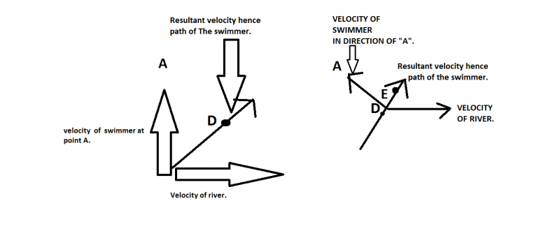

No.And the man swims so that his velocity with respect to the water is always towards A.
Actually I think the following image will explain why BC is path of the swimmer/person.
I have changed this a little bit.That's why refer image of my post #36 rather than the one below.
That's what I wanted to ask ,so I asked in my post #13
gracy said:
So If I would say A is moving with velocity 5 m/s with respect to ground along the line joining AB.And B is at rest ,what is velocity approach ,of A with respect to B? it will be 5 m/s ?
Because here point A is stationary,and swimmer is going towards it with velocity u along the lining the two.So his approach velocity towards A should be u - 0=u.
But as my teacher had taken his approach velocity u - u sin theta giving the following explanation.
As you can see the image of my post #30
component of river velocity in direction opposite to that of velocity of swimmer is u cos (90- theta)=u sin theta
Note:-y and x are my coordinates in the image of #30.
So over all velocity of approach (u - u sin theta) - 0=u - u sin theta
So I was having confusion whether we can include other velocities if present in the same direction or opposite to the direction of the line joining the person/swimmer and point A.
