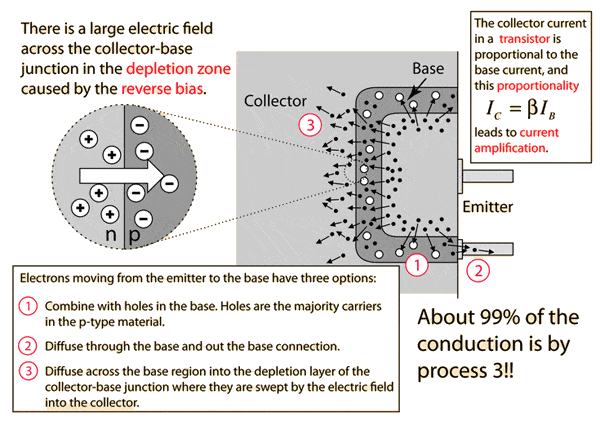

This is a good read on Transistor Action.
I have went through the link you provided, but this doesn't touch on the question.
