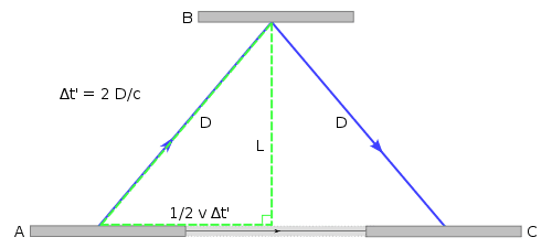

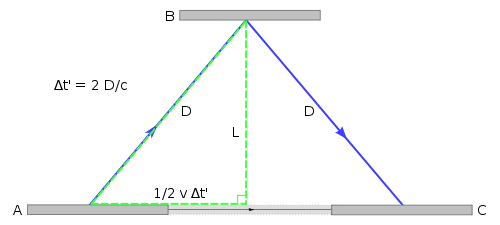

I was asking about this diagram in reference to an atomic clock traveling at speeds near c.
they show the bottom length of the right triangle as 1/2vΔt'
since we are viewing it from a different frame, shouldn't that length be contracted?
You mean a 'light clock', not an atomic clock.
No. That's the horizontal distance traveled by the clock. It's not the length of anything. In the rest frame of the clock, that distance is zero. Length contraction is irrelevant.
Only the lengths of the mirrors are contracted but that is of no consequence in illustrating how a light clock works when the mirrors are placed orthogonal to the direction of motion. If you rotated the light clock by 90 degrees so the light went forward to hit the first mirror and then came back to hit the second mirror, then the distance between the mirrors would have to be shown contracted in order for the orientation of this light clock to tick at the same rate as the one you showed, but that form of the light clock is very difficult to illustrate in a static picture so it is not often done.
