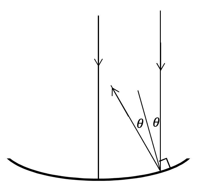

The parabolic mirror pictured below is such that all incident rays, neglecting diffraction, are reflected towards a focus.

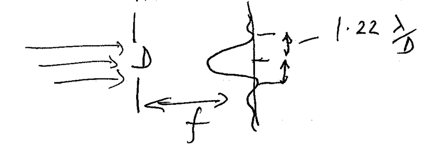

A question states that the light cannot be focused to a point precisely, since there exists a circular diffraction pattern in the focal plane. The following diagram is given:
I'm trying to understand how to calculate the drop in intensity at the image, supposing the intensity of light from the source before it enters the telescope is known. I understand that we can approximate to a reasonable degree of accuracy that only the light in the central maximum within ##\theta = \frac{1.22\lambda}{2}## need be considered; then a ratio of areas can be used for the intensity.
But I can't actually see what ##D## is referring to in the second figure; I assume ##f## is the focal length. Where is the diffraction actually occurring in the parabolic mirror? Thanks!

D is the primary mirror diameter - the second diagram has "unfolded" the optical path at the mirror, so the mirror is just a hole. Note that this is implicitly assuming that you're trying to image a point source with a circular primary mirror and a negligible secondary - life is more complicated in reality!

Traditionally we would say that the aperture is composed of Huygens's Sources and these produce the pattern you see in the vicinity of the focus. It is like a diffraction grating.
Conversely, for a searchlight or dish antenna, if we place a point source at the focus, the searchlight beam will have a finite angular width and will have side lobes in a similar way.

To add to the above, there are two ways to compute the diffraction pattern result from an aperture plus a focusing optic:
1) You can simply treat the aperture with (far-field) diffraction theory and assume that the optical element gives you the far-field diffraction pattern (from the aperture) in the focal plane, (with a conversion factor ## x=f \theta ##),
or
2) you can assume the Huygens sources are located on the focusing optic, with a phase determined by the shape of the focusing optic, and you compute the near-field diffraction pattern in the focal plane. For the paraboloid, ##4fz=r^2 ## gives the shape of the paraboloid as a function of ## r ##, and ## \Delta=2z =r^2/(2f)## is how much the optical path length is shortened as a function of ## r ##, from which the phases of the Huygens sources can be computed.
