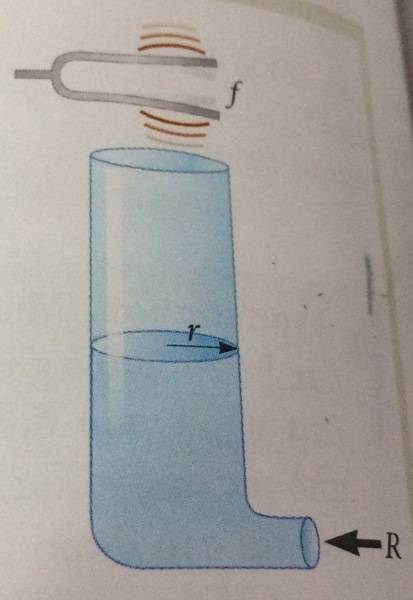

At a long, vertical tube, water is poured in, with an inflow R = 1.00 L/min = 1.67 * 10-5 m3/s. The radius, r = 5.00 cm. At the open end, a tuning fork is oscillating with a frequency of f = 512 Hz. What's the time difference between two consecutive configurations, while the water slowly rises?

f = n*v/4L
Alright, in this case, we have a constant f that doesn't change, an L that keeps getting shorter, and we're in a "tube with one end open, one end closed" environment.
>Volume of the water: V = π*r2*h = 7.85 * 10-3m2*h
>hstart = 0 & Lstart = max
>h keeps going up, while L keeps going "down"
>every 1s, a volume of V = 1.67 * 10-5 m3 is added. So, (using the V formula from the first >), we have h = 2.13 * 10-3 m. So the height of the water goes up by said h every 1s.
And that's where I get stuck. Initially I figured I'd say that the given f is the harmonic, put n=1, v = 343 m/s, and find the initial/max length L. But as I kept upping the ante on n (3,5,7), the L kept growing, which wasn't realistic, since it should go down. So that's one out.
Any help is appreciated!
Why do you assume the first resonance is at the fundamental frequency?
Well, at first I did so because I thought that I'd use it to find the entire length of the tube. Obviously that was wrong. I'm out of ideas though.
But you do not need to find that.
What L values do you get for n=1, 2, 3?
It's an open/closed tube, so f = n*v/4L & n = 1,3,5,7..., right?
>n = 1: L = 0.168 m
>n = 3: L = 0.502 m
>n = 5: L = 0.837 m
>n = 1: L = 0.168 m
>n = 3: L = 0.502 m
>n = 5: L = 0.837 m
So how big is each step?
From 1 to 3 it's 0.334 m & from 3 to 5 it's 0.335 m.
Within rounding error, they're the same, right? Can you generalise to the step from n to n+1?
Can you relate those distance steps to the time intervals?
My problem is that if I go higher (5, 7, 9), then the steps change a bit. From 5 to 7 it's 0.333. From 7 to 9 it's 0.331. I guess it's to be attributed to the rounding error, but there is a difference.
Something like this?
>fn = n*v/4Ln
>fn+1 = (n+1)*v/4Ln+1
>fn = fn+1
___________________________
fn+1/fn = ((n+1)*v/4Ln+1)/(n*v/4Ln) <=> n*Ln+1 = (n+1)*Ln <=> Ln+1 = ((n+1)/n)*Ln
I'm a bit stuck on that.
Darthkostis said:
fn = n*v/4Ln
The frequency is fixed.
Yeah, it's stable, 512 Hz, right? I factored that in (fn = fn+1) and ended up with Ln+1 = ((n+1)/n)*Ln
True, but not as useful as finding Ln+1-Ln.
Well, in that case: Ln+1 - Ln = Ln/n
Still not that useful. Try to get an expression that has no L term on the right. It will have v.
Yeah, I forgot about that: f = n*v/4*Ln <=> Ln = n*v/4*f || So we have: Ln+1 - Ln = (n*v/4*f)*(1/n) = v/4*f = 343 m/s / 4*512 Hz = 0.167 m
Right. How long will it take for the air column to change in length by that mch?
Based on what I found previously (first post):
In 1 s, the water rises by 2.13 * 10-3 m, so the Length decreases by so.
How much time, x, do we need for the Length to change by 0.167 m ?
By doing the Rule of Three I end up with 78.4 s, which is about half of the book's answer (158 s).
Sorry, I did not check this equation:
Darthkostis said:
f = n*v/4L
That is not right for a half open tube.
Isn't it a tube with one end closed, and one end open? The top is the open part, and the bottom is the closed one. That's what my book has, with n being able to take the values of 1,3,5,7...
Oh ok, if that is how n is being defined... But you took consecutive values as n, n+1 instead of n and n+2.
Oh yes, darn it. Yeah, rookie mistake. Taking that into account:
>fn = n*v/4Ln
>fn+2 = (n+2)*v/4Ln+2
>fn = fn+2
fn+2/fn = ((n+2)*v/4Ln+2)/(n*v/4Ln) <=> n*Ln+2 = (n+2)*Ln <=> Ln+2 = ((n+2)/n)*Ln <=> Ln+2 - Ln = 2*Ln/n
Ln = n*v/4*f
_____________________________
Ln+2 - Ln = 2/n * nv/4f = 2v/4f = v/2f = 343 m/s / 2*512 Hz = 0.335 m
Following the Rule of Three, same as before:
How much time, x, do we need for the Length to change by 0.335 m ?
And so we get x = 157.3 s || A bit off from the book's answer, but that's due to all the multiplications/divisions, Significant Digits and whatnot.
Thanks a ton for the help and the patience!
