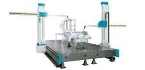

Was done in early 1980’s by many CMM manufacturers
Case in point dual arm body checkers to automatically measure cars – see photo

Typically these dual horizontal arm Coordinate measurement machines share a common x,y,z table and over lap by 100 mm as they both calibrate on one common datum sphere to identify their positions in the measurement volume. Each HA arm moves in xyz and the heads rotate in A and B axis to you have a 10 axis movement
Thankyou all for the replies.
I think that based on the information here, my best bet will be the dual robotic arms as per the picture above, but on a rotating bed to allow them to rotate around themselves.
Cheers guys!
