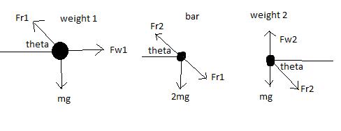

A dumbbell consisting of two weights of mass m and a bar connecting them of length L is sliding down a frictionless wall and floor, with one weight on the wall and one on the floor. The dumbbell starts sliding from rest. Find the speed of the two weights when they are equal in speed.
I tried solving this problem as follows but the answer I am getting is wrong.
Here is my diagram:
Wight 1 is the one sliding down the wall, the "bar" particle is the centre of mass of the dumbbell, and weight 2 is the one sliding on the floor.
##F_{r1}## is the force of the bar on weight 1, ##F_{w1}## is the force of the wall, ##F_{w2}## is the normal contact force on weight 2, ##F_{r2}## is the force of the bar on weight 2. The directions of these forces was worked out by considering the direction of the net force acting on each weight. Theta is the angle that the bar makes with the horizontal at time t.
I found the following equations by resolving forces, and for the bar, using the fact that ##\mathbf{F}_{ext}=M\mathbf{a}_{cm}##:
##(F_{r1}-F_{r2})\cos \theta = ma_2##
##(F_{r1}-F_{r2})\sin \theta - -2mg - ma_1##
##F_{r2}\cos \theta = ma_2##
##F_{r1}\sin \theta - mg = ma_1##
I solved these to get ##a_1=-\frac{5g}{3}## and ##a_2=-\frac{l}{h}\frac{g}{3}## where ##l## is the component of the bar in the x direction and h is its component in the y direction, both at time t.
Also, based on the definitions of h and l, I got ##h^2+l^2=L^2## which I differentiated with respect to time (since h and l are variable) to get ##h\frac{dh}{dt}+l\frac{dl}{t}=0##. Now I noted that the derivatives in this equation are the speeds of the weights, ie ##\frac{dh}{dt}=v_1## and ##\frac{dl}{dy}=v_2##, since these are the rates at which the weights slide on the wall and floor respectively. Also, the signs are correct because h is getting smaller which agrees with the fact that ##v_1## is negative, and similarly for the ##v_2## equation.
Now when the speeds are equal, let that speed be ##v>0##. Then ##v_1<0## and so ##v_1=-v##, while ##v_2=v##. Plugging into the derivative equation and simplifying we get ##h=l##. So by the pythagorean equation we get ##h=l=\frac{L}{\sqrt{2}}##.
Now differentiating the pythagorean equation again we get ##(\frac{dh}{dt})^2+h\frac{d^2h}{dt^2}+(\frac{dl}{dt})^2+l\frac{d^2l}{dt^2}=0##, ie ##2v^2+\frac{L}{\sqrt{2}}a_1\frac{L}{\sqrt{2}} a_2=0##, and using the values of ##a_1,a_2## we got at the beginning, this becomes ##2v^2=\frac{L}{\sqrt{2}}2g## or finally ##v=\sqrt{\frac{g}{\sqrt{2}}}\sqrt{L}##, which is the wrong answer. I am not sure where I went wrong.

Hi, I read your expose a few times and have trouble understanding what you do. You use symbols you don't explain and explain symbols you don't use. You say
walking said:
I solved these
without showing what you did and come with an answer independent of ##\theta##.
In your diagram
245616
there is definitely no force of ##2mg## working on the center (in addition to the two ##mg## on the weights). That center is massless and describes a quarter circle during the slide down. Nothing useful for solving the problem there.
You 'use' a fact ## {\bf F}_{ext} = M {\bf a}_{cm}## where upper case ##M## is what ? and ## {\bf F}_{ext} \ ## is what ? and ##{\bf a}_{cm}\ ## is what ?
##F_{r1}## is working on weight 1 only, it can never occur in something like ##(F_{r1}-F_{r2})\cos \theta = ma_2 ##, presumably the equation of motion for weight 2.

Not negative at all, it was my fault for being unclear, sorry.
I will try to clarify what I did but I may still miss some things, please just let me know and I will describe them.
The outline of my solution is basically using NII on weight 1, then on weight 2, and finally by using NII on the system as a whole by considering the dumb-bell as a particle and using the fact that the centre of mass of a system moves like "a particle under an external force". The formula I learned for the latter is ##F_{ext}=Ma_{cm}## where ##F_{ext}## is the net external force on the system, ##M## is total mass and ##a_{cm}## is the acceleration of the centre of mass. So the centre of mass of the system can be modeled as having mass 2m as I did. (I am assuming the bar is massless.)
Regarding the forces, I have already defined them so I don't see what is confusing. The force of the bar on weight 1 is ##F_{r1}##, and by NIII the weight acts on the bar with the same magnitude force ##F_{r1}## but in the opposite direction as shown in the diagram. I hope the other forces are clearer now that I have explained how I was using the centre of mass.
I eliminated the angle simply by adding equations together etc. I don't have my notes at the moment but it is a simple case of solving simultaneous equations. I am sure I didn't make a mistake during this step. The ##F_{r1}-F_{r2}## etc is from resolving in the x and y directions for the centre of mass of the system, using ##F_{ext}=Ma_{cm}=ma_1+ma_2## where the forces and accelerations are vectors. Then I simply equated vector components of both sides, noting that ##a_1## (the acceleration downwards of weight 1) doesn't have an x component and ##a_2## doesn't have a y component. This is how I got the simple "##F_{r1}-F_{r2}##" equations. All the equations are from resolving the forces in the diagram I provided.
My assumptions:
The bar is massless and thin. The weights are not point-like and I don't need to assume this in my solution. I use the x and y components of the length L of the bar regardless of how big the weights are. The weights are spherical
Please let me know if anything else needs to be clarified, I really am not seeing why the answer I got is incorrect.

walking said:
I solved these to get ##a1=-\frac{5g}{3}## and ##a2=-\frac{l}{h}\frac{g}{3}## where l is the component of the bar in the x direction and h is its component in the y direction, both at time t.
This can't be right. ##a_1## is constant, doesn't depend on ##l## and is greater than ##g##?
PS You should be able to see that ##a_1 \rightarrow 0## as ##h \rightarrow L##; and ##a_1 \rightarrow g## as ##h \rightarrow 0##. That should be a sanity check on your equation for ##a_1##.

If I use your diagram in post #1 (erasing the middle one) and explain that
##\vec a_1## is the acceleration of weight 1
##\vec a_2## is the acceleration of weight 2
##\vec a_1## is in the vertical direction: ##\vec a_1 = (0, a_1)##
##\vec a_2## is in the horizontal direction: ##\vec a_2 = (a_2, 0)##
I get the following equations $$\begin{align*}
&F_{r1}\cos\theta & + F_{w1}& = {}& 0 \\
&F_{r1}\sin\theta & + mg & = {}& ma_1 \\
&F_{r2}\cos\theta & & = {}& ma_2 \\
&F_{r2}\sin\theta & + mg & ={} & 0 \end {align*}$$
(the last one eliminates ##F_{r2}##)
We assume ##F_{r1}## and ##F_{r2}=0## are both acting in the direction of the bar which needs an argument.
To get anywhere with this, we need more: we have four equations with 6 unknowns. So you need something like ##F_{r1}+F_{r2}=0 ## which needs an argument too, plus e.g. a relationship between ##a_1## and ##a_2## (without intrducing new unknowns, of course).
To do this with Newton equations of motion doesn't look promising to me, but I would like to be proven wrong.
