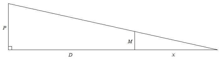

1. A street light is at the top of a 10.000 ft. tall pole. A man 5.000 ft tall walks away from the pole with a speed of 5.000 feet/sec along a straight path. How fast is the tip of his shadow moving when he is 31.000 feet from the pole?
Please refer to the following diagram:
$P$ is the height of the pole, $M$ is the height of the man, $D$ is the man's distance from the pole, and $x$ is the length of the shadow.
By similarity, we find:
$$\frac{D+x}{P}=\frac{x}{M}$$
$$DM+Mx=Px$$
$$x=\frac{DM}{P-M}$$
Observing that $x$ and $D$ are changing with time, we find by implcitly differentiating with respect to time $t$, we have:
$$\frac{dx}{dt}=\frac{M}{P-M}\frac{dD}{dt}$$
Also observing that movement of the tip of the man's shadow is the result not only of the shadow growing but also of the man's movement, we find that we must add these rates of change, so that the rate of change of the point $T$ of the tip of the shadow is given by:
$$\frac{dT}{dt}=\frac{dD}{dt}+\frac{dx}{dt}=\frac{dD}{dt}\left(1+\frac{M}{P-M} \right)=\frac{P}{P-M}\frac{dD}{dt}$$
Now, using the given data (did you notice we do not need $D$?):
$$P=10\text{ ft},\,M=5\text{ ft},\,\frac{dD}{dt}=5\,\frac{\text{ft}}{\text{s}}$$
We find:
$$\frac{dT}{dt}=\frac{10}{10-5}\cdot5\,\frac{\text{ft}}{\text{s}}=10\, \frac{\text{ft}}{\text{s}}$$

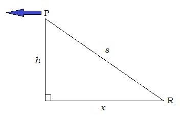

4. A plane that is flying horizontally at an altitude of 6 kilometers and a speed of 570 kilometers per hour passes directly over a radar station. How fast is the distance between the plane and the radar station increasing when the distance between the two is 19 kilometers?
First, let's draw a diagram:
The plane is at $P$, the radar station is at $R$, $h$ is the altitude of the plane (which is constant since its flight is said to be horizontal) and $x$ is the distance from the radar station to the point on the ground (or at the same level as the radar station) directly below the plane. $s$ is the distance from the plane the the radar station.
Using the Pythagorean theorem, we may state:
(1) $$x^2+h^2=s^2$$
Implicitly differentiating (1) with respect to time $t$, we find:
$$2x\frac{dx}{dt}=2s\frac{ds}{dt}$$
We are interested in solving for $$\frac{ds}{dt}$$ since we are asked to find the rate at which the distance from the plane to the station is increasing when it is 19 km away from the station. So, we find:
$$\frac{ds}{dt}=\frac{x}{s}\frac{dx}{dt}$$
Now, we do not know $x$ but we know $h$ and $s$, and so solving (1) for $x$ (and taking the positive root since it represents a distance), we find:
$$x=\sqrt{s^2-h^2}$$
And so we have:
$$\frac{ds}{dt}=\frac{\sqrt{s^2-h^2}}{s}\frac{dx}{dt}$$
Now, the speed $v$ of the plane represents the time rate of change of $x$, hence:
$$v=\frac{dx}{dt}$$
and so we may write:
$$\frac{ds}{dt}=\frac{v\sqrt{s^2-h^2}}{s}$$
Now, we may plug in the given data:
$$v=470\frac{\text{mi}}{\text{hr}},\,s=19\text{ km},\,h=6\text{ km}$$
and we then find:
$$\frac{ds}{dt}=\frac{570\sqrt{19^2-6^2}}{19} \frac{\text{km}}{\text{hr}}=150\sqrt{13} \frac{\text{km}}{\text{hr}}$$
