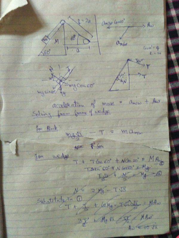

In summary, the problem involves a block of mass 2kg on a wedge of mass 8kg, with pulleys and thread that are massless and smooth surfaces. The goal is to find the initial acceleration of the wedge. It is important to consider that the motion of the block will not be aligned with the slope of the wedge as the wedge moves, and to include tension along the incline in the free body diagram of the wedge.

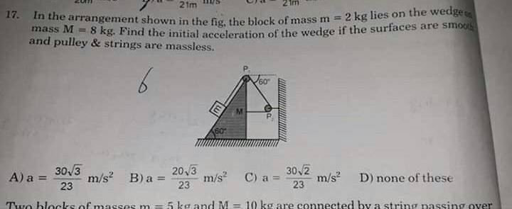

In the arrangement shown in the figure, a block of mass m=2kg lies on the wedge of mass M=8kg.Find the initial acceleration of the wedge.
Assume pulleys and thread massless and surfaces smooth.
FBDs
Problem Statement: In the arrangement shown in the figure, a block of mass m=2kg lies on the wedge of mass M=8kg.Find the initial acceleration of the wedge.
Relevant Equations: FBDs
It is hard to read what you did, you didn't introduce coordinates or describe what you calculated. It would be much easier if you show your work here in the thread and describe it as well.
Keep in mind that the motion of the block will not be aligned with the slope of the wedge as the wedge moves.
In your FBD of the wedge it looks like you missed tension ##T## along the incline.
Likes A185
