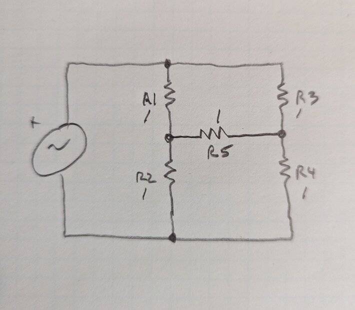

Given a flow network, which could be any connected set of N resistors, or water pipes, etc. of any finite ohmage, diameter etc. and connected in any sort of parallel, series, delta-wye combinations. Under an applied energy gradient (voltage, gravity etc.), a flow will occur through this network, and each branch of the network will exhibit a non-zero flux.
Hypothesis: Upon gradient application, this network + fluid system will spontaneously converge to a specific set of flux allocations for each branch, and the sum of all branch fluxes will be a maximum possible for the given system metrics. True?
There are some branches that may have zero flux, for example, a balanced bridge network.
Not always. for example, a balanced bridge network:
SteveMaryland said:
by what means (selection, trial/error, filtering, sortation) do flow systems in general converge to a "solution"?
A nearly impossible question to answer, in general (non-linear networks, for example). Linear networks will have solution(s) as in a set of linear algebra equations.
