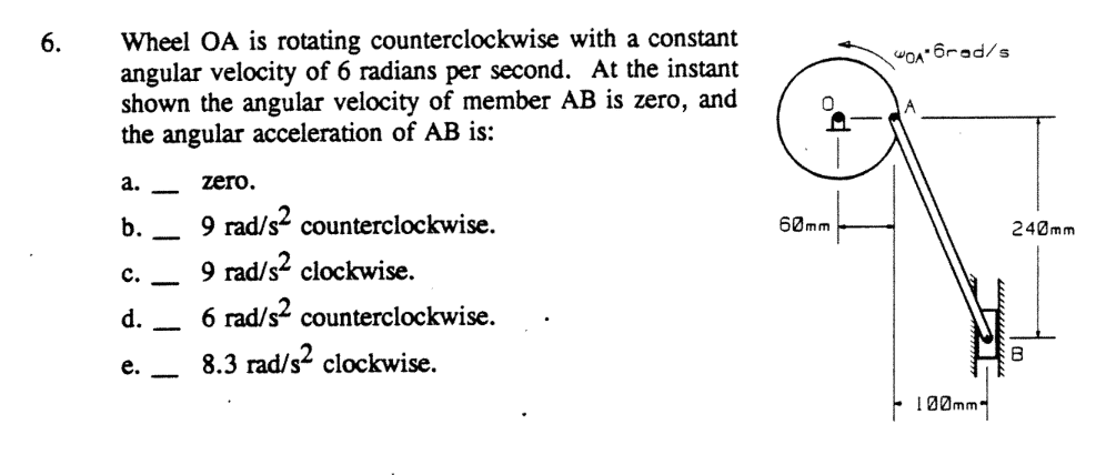

Dynamics: Angular Acceleration Problem
In summary: Ly^*\cos{\phi_0}=0$$In summary, the rod is not rotating at this instance and angular acceleration is 0.
sandmanvgc
26
At this point both point A and block B are moving in parallel, as well as the question stating angular velocity is 0, my assumption was due to both ends moving in same direction parallel that the rod is not rotating at this instance and the answer is a. angular acceleration = 0. This does not line up with the answer key and I'm at a loss at this point. Answer Key is b. Am I misinterpreting the question?
Angular Acceleration = r*sqr(angular velocity)
Both point A and B are moving in parallel in same direction, therefore rod is not rotating at this instance and angular acceleration is 0. Question states angular velocity is equal to zero.
Plugging into Angular Acceleration"AB" = r*sqr(angular velocity"AB") = 0.26m* sqr(0) = 0

Hello sandman, ##\qquad## :welcome: ##\qquad## !
Agreed.
But I don't understand where your relevant equation comes from: it doesn't even match dimensionally.
How about ##\alpha = {d\omega\over dt }## ?

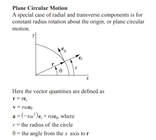

Would I solve for tangential acceleration and use
##a_t=R\alpha##?
Of what wrt to what ?
In my judgment, this is not such a simple kinematics problem. For the initial geometry, drop a vertical line from point A, and draw a horizontal line to the left from point B. Where these lines cross, take it as the origin of a Cartesian coordinate system. Let the length of the rod be L, and let the angle that the rod makes with the vertical at any time be ##\phi##. Then, at time zero, $$x_A=0$$$$y_A=L\cos{\phi_0}$$$$x_B=L\sin{\phi_0}$$and $$y_B=0$$where ##\phi_0## is the initial value of ##\phi##.
Let R be the radius of the wheel. Then at time t, the coordinates of points A and B are: $$x_A=R\cos{\omega t}-R$$$$y_A=L\cos{\phi_0}+R\sin{\omega t}$$$$x_B=L\sin{\phi_0}$$$$y_B=y$$where y is next to be determined.
OK so far??

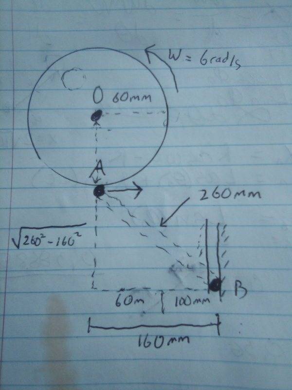

Due to the holiday I have been tied up and regret my absence and appreciate Chestermiller's effort to carry out the remainder of the work. My original thought from my earlier post was to use the fact that wheel is rotating consistently to try the following to solve the problem. Attachment below shows diagram in relation to my method.
246203
$$V_Bx=V_Ax+\frac{160}{260}V_\frac{B}{A}$$
$$0=0.36m/s+\frac{160}{260}V_\frac{B}{A}$$
$$V_\frac{B}{A}=0.36m/s\frac{260}{160}$$
$$V_\frac{B}{A}=0.26mω=0.36m/s\frac{260}{160}$$
$$ω=2.25rad/s$$​
Then taking the time it would take point A to move from my drawn point to the point in the original drawing from the problem.
$$\frac{pi/2}{6rad/s}=0.261799sec$$
$$\alpha=\frac{\delta\omega}{\delta t}$$
$$α=\frac{2.25rad/s−0}{0−0.261799s}=8.6\frac{rad}{s^2}counterclockwise$$​
While method above comes close it doesn't get it exactly right as Chestermiller's process does and I was wandering why my method isn't coming as close , if I messed up a calculation, or if it is entirely not practical?

Is this what your referring to?$$\vec a_\text{A} = 0.6rad(6^2)\frac{rad^2}{s^2} = 21.6 i = \vec a_\text{B}j + \vec \alpha_\text{A/B} k \times \vec r[\frac{5}{13}i +\frac{12}{13}j]$$
$$21.6 i = \vec a_\text{B}j + \vec \alpha_\text{A/B} k \times [\frac{130}{1300}i +\frac{312}{1300}j]$$
$$21.6 i = \vec a_\text{B}j -\frac{3\vec \alpha_\text{A/B}}{13}i +\frac{\vec \alpha_\text{A/B}}{10}j$$

Coming back to this, I'm actually incredibly confused now and am wondering If my answer was just a coincidence. I've been getting mixed up with remembering my drawing and the original one from problem. How would taking x component help here as in diagram both a and b are moving vertically?
The velocities point upward, but you're interested in the accelerations, which depend only on how the velocities are changing. Don't confuse the direction of velocity with the direction of acceleration.
So just to clarify, the acceleration we solved for ##\vec{a}_A = -r\omega^2## or in the diagram below ##e_r## is always perpendicular to the motion of the object and for our case that is why A would be accelerating in what we designated as the x plane?
246265
##\vec{a}_B## is equal to zero only because B is confined to a vertical motion or could the following work?
##\vec{a}_B =\omega_B^2R_\text{B/A} = \omega^2R_\text{B/A} = (0^2)(R_\text{B/A}) = 0?##
You can't say that a vector is equal
$$\underbrace{\vec{a}_A}_\text{magnitude and direction} \ne \underbrace{-r\omega^2}_\text{just "magnitude"}$$
I'm not sure what you're asking. If an object follows a circular path at constant speed, which way does its acceleration point?
##\vec{a}_\text{B}## isn't equal to 0.
Again, this doesn't make sense because you're saying a vector equal to a scalar. It's like trying to say a matrix is equal to a number. Even if you're just referring to magnitudes here, I don't follow at all what you're thinking is. What does ##\omega_B## represent? How is it different from ##\omega##?
My question was does ##{a}_\text{Bx*}=0## only because the diagram confines it to vertical motion or does the angular velocity of the rod equal angular velocity of B with respect to A and we could use the following below to explain why ##{a}_\text{Bx}=0## has no x component as well.
##a_\text{Bx}=\omega_{B}^2R_\text{B/A} = -R_\text{B/A}\omega_B^2 = -R_\text{B/A}\omega_\text{B/A}^2 = -R_\text{B/A}(0)^2 =0?##
  • #31
Think about this: Why are you singling out the x-component here? Couldn't you make the same argument for the y-component?
