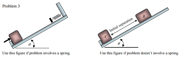

The 10 kg block is at rest on the bottom of the incline (θ = 30°) when it is suddenly struck by a 50 kN force that sends it sliding up the incline. The duration of the force is 5 ms and the coefficient of kinetic friction between the block and the incline is 0.2. The block slides 30 m up the incline and makes contact with the spring (initially uncompressed, k = 15 kN/m). What is the maximum compression of the spring
