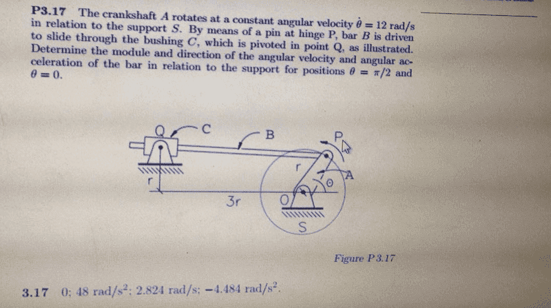

Dynamics problem: Crankshaft angular speed?

Kinematic theorems:

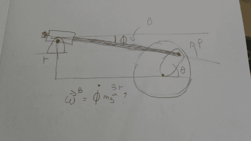

Ok, I'm trying to use another angle, phi, and find some relation betwen phi and theta so I can derive the equation for the angular velocity of rod B with respect to S, but I'm stuck at that point. How should I proceed with this problem?
Hint : Use the x y coordinates of the crank pin .
