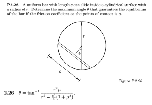

A uniform bar with length c can slide a cylindrical surface with a radius of r. Determine the maximum angle theta that guarantees the equilibrium of the bar if the friction coefficient at the points of contact is u.
Friction force = u*N (where N is the normal force, and u is the friction coefficient).
Okay, I'm really lost with this exercise. I didn't understand the statement. The bar is at the top of a cylindrical surface, and can slide within it, or is the cylinder hollow and the bar is supported on both ends by the friction force (touching the inside walls of the cylinder)? For me, the second option makes more sense, but how would the bar slide then?
I would appreciate any help.
Small print says inside in the original problem statement . So it is a bar inside a tube .

So it's the bar supported on both ends by the tube walls? I didn't understand what the question means by equilibrium... Does the bar rotates around some point? I'm really not sure about how does the angle changes.
Equilibrium just means not moving in this case . This is essentially a static analysis problem .
The bar does not start from some unknown initial angle and slide round until it comes to a halt .
Think of it more like a lab experiment where you place the bar in the tube by hand at a range of test angles and note for which angles the bar stays put and for which angles it slides(1) .
This problem is really only a variation of the 'ladder against the wall ' problem .
Note (1) :There is a range of angles where the bar could tip over or fall down rather than just slip .

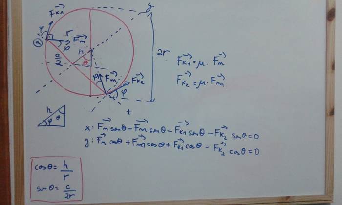

Ok, I'm working again on the problem, and I'm having trouble to figure out relationships between the angles.
Here's a rough sketch (showing only the normal forces):
Where Fn and Fm are the normal forces.
I'm trying to express phi and alpha in therms of theta, so I can decompose the x and y components and write the equilbrium equations.

Not much, I fear.I think I established a relationship between the angles (but I'm not sure if I made it correctly). I found out that sin(phi) = cos(theta).
That's what I did:
Then I came up with those two equilibrium equations in x and y, but got stuck there (note: my professor said that we don't have to account for the gravity force, but he hasn't been very helpful beyond that. Anyway, I left it out there). Solving the equations led me nowhere.
EDIT: Also, I've considered that the friction forces are perpendicular to the radius of the circle. Is that right?
Now I see that I've made incorrect assumptions in my prior attempt, but I'm still stuck with those angles.

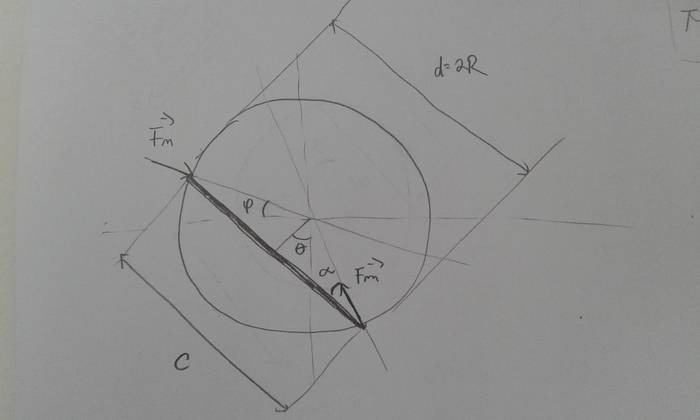

Okay, I've struggled a little bit with those angles, but if I'm not mistake again, then phi = theta.
Also, I've added the gravity force again (which was absent in my last picture).
Now I have three equilibrium equations:
x: Fg*sin(theta) + Fn*cos(theta) - Fm*cos(theta) - uFn*sin(theta) - uFm*sin(theta) = 0
y: -Fgcos(theta) + Fn*sin(theta) + Fm*sin(theta) + u*Fn*cos(theta) - u*Fm*cos(theta) = 0
Moment: -Fg*cos(theta)*(c/2) + Fm*sin(theta)*c - u*Fm*cos(theta)*c = 0
Where u is the friction constant, and c is the length of the rod. Fn and Fm are normal forces, and Fg is the gravity force.
Solving those equations should give me expressions for Fg, Fm and Fn, right? After that, I should isolate theta in one of those equations, and that would give me the answer?
The method you are using is not exactly incorrect but it is more complicated than needs be and does not really reflect the essential nature of the problem .
Think about the problem this way :
The bar when set at any particular angle can only be in one of two conditions - static or in motion .
There are driving forces trying to cause motion of the bar and retarding forces trying to prevent motion .
Depending on the relative magnitude of these forces the bar will move or it will not .
So can you see a way of analysing this problem in terms of driving forces and retarding forces .?

Let me guess... My driving forces will be the gravity force and the normal forces, while the retarding forces will be the friction forces.
The conditions for equilbrium are R(resultant) = 0 and M(torque with respect to some point) = 0.
Anyway, I will have to decompose the forces using the angles the way I was doing before, right?
Ok, think I've got something...
If I calculate the distance from the center of mass of the rod (where the gravity force is being applied) to the center of the tube, I will get:
$$ \sqrt{r^2 - \frac{c^2}{4}}$$
The cross product of this position vector with the gravity force will be the torque of this point around the center of the tube.
Now I have to find a way to express the gravity force in terms of u (the friction constant), and r...
