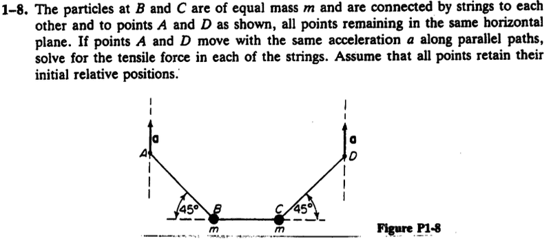

If particles at B and C of equal mass m are connected by strings to each and to points A and D as shown, all points remaining in the same horizontal plane. If points A and D move with the same acceleration a along parallel paths, solve for the tensile force in each of the strings. Assume that all points retain their initial relative positions.
PLEASE SEE ATTACHMENT
Kinematics- total acceleration:
A = 0(i) + g(-j) + a(j) + 0(k) = Ax(i) + Ay(j) + Az(k)
Mechanics:
∑F - mA = 0;
Magnitude of acceleration due to gravity:
g =9.81
Labeling:
Tension between A & B: Tab, etc
Coordinate System:
x to the right
y upwards
z out of the page
Freebody Diagram on left point mass (EQ1)
∑F1 - mA = 0 = Tab*cosd(45)(-i) + Tbc(i) + Tab*sind(45)(j) - mA
Freebody Diagram on right point mass (EQ2)
∑F2 - mA = 0 = Tdc*cosd(45)(i) + Tbc(-i) + Tdc*sind(45)(j) - mA
SOLVING:
x-componenets of (EQ1) and (EQ2):
Tab = Tdc
Substituting Tab for Tdc into (EQ2) y-component:
m( g(-j) + a(j) ) = Tab*sind(45)(j)
Showing y-component of (EQ1):
m( g(-j) + a(j) ) = Tab*sind(45)(j)RESULTING:
=> Tab = sqrt(2)mAy = Tdc
=> Tbc = mAy
note:
A =
Ay = -g + a
My Questions:
1) The sign of acceleration due to gravity (g) is negative while on the external forces side of the equation, when usually it is negative. Which tells me that there is something wrong with my acceleration term.
2) But, how else can we solve this problem without including the acceleration due to gravity in the total acceleration? Else, I would need to totally neglect it from the solution.
3) If neglected is that the same thing as considering only the dynamic case? i.e. forget the weight = mg. Why? Is there a more intuitive approach?Thank you.
g is a positive constant that describes the strength of the gravitation field.
The acceleration is given as "a"; g is not part of that.
You are forgetting part of the problem statement, namely the part about "all points remaining in the same horizontal plane." Horizontal, right? So which way does gravity point? So these things must all be taking place on a table of some kind. Right? No gravity involved.
For future reference, you get these things with the sign of things like gravity correct by remembering they are vectors. That is, they have a magnitude and a direction. So gravity points "down." You pick the direction that will be positive, and that tells you the sign.
Doc Al said:
g is a positive constant that describes the strength of the gravitation field. The acceleration is given as "a"; g is not part of that.
Ok I would agree with you too, however, the problem forces me to do one of two things to get the same result:
1) ignore the weight term. I think some call it the dynamic case.
or
2) the weight term is in fact apart of the total acceleration.
Answer:
Tab = Tdc = sqrt(2)*m*a
I think you are totally right about it being on a horizontal plane. This take care of the solution. Wow. Thanks.
I don't know what you mean about the directions, I believe I did show them.
or
You certainly do not want to ignore the weight of the masses! But that doesn't mean g is part of their acceleration.
ltkach2015 said:
Answer:
I'd say that answer is incorrect.
Edit: I misread the problem. Since everything is in a horizontal plane, g plays no role.
D'oh! I missed that. (I had assumed they meant that the masses remain in a horizontal line.)
Good catch, DEvens.
