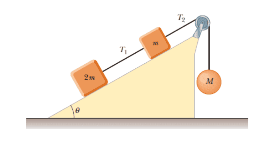

A mass m is 5kg and another mass, M=6kg. Find the acceleration of this system if the kinetic friction is 0.1 and theta = 30 degrees. Find all tensions of connecting ropes. For which values of M will the system stay in an equilibrium position?Assume that the static friction coefficient is 0.15. Disregard the mass of the pulley and ropes.

This image was provided, I've completed the first part of the question and got a = 4.8m/s^2 as well as T1= 24.5N and T2=34.3N. not sure about my answers though. also I don't understand the mass in static equilibrium part, can anyone explain how to solve that? Thanks.
