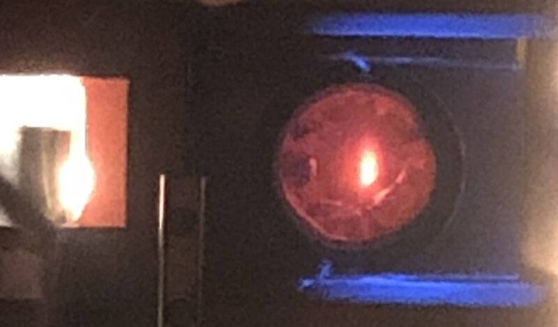

Hi all,
Hope we have some electron beam evaporation specialists in the house.
I'm working with an Telemark Electron Beam Source (Linear Multi-pocket and would like some help with the issues I am facing currently. I'm seeing blue light around both sides of the crucible when the e-beam is turned on. The electron beam is no longer focused, it is spread (in arc shape) in the direction perpendicular to the high voltage. I have tried adjusting the high voltage (in the range of 7 to 9kV) and changed the filament hoping it would help but it hasn't made any difference. How to fix this problem?
Thanks
AK
It's been a VERY long time since I've been near such a device, but the obvious thing to check first is the focus coil and its supply. If I recall correctly, for a fixed beam location, the focus coil source should be a steady DC.
You also mentioned that the beam is shaped as an arc. That sounds like the deflection coils are being fed AC, making it look like a focus problem. Put an oscilloscope on them to check.
Good Luck! and let us know what you find.
Tom

1) The beam is grossly mis-centered and you are seeing only the edge of it.
2) The deflection circuits are involved in the problem, or more specifically, something common to both the X and Y deflection systems.
An even remoter possibility is that of another piece of nearby equipment that is generating a strong magnetic field.

Hi Tom,
Many thanks for your all the efforts answering my questions. I really appreciate it.
All the suggested points were investigated and it was found that most of the beam was in the centre, but some part of the beam was hitting the edge of the crucible. In addition, a blue flourosence was observed. That flourosence was never obsered before when beam is centered.
Please see the picture of the beam herewith attached. The emitter is at the down-Left of the image. I have checked everything mentioned in troubleshoot section of the manual and found everything fine with the system.
Any additional comments/suggestions are welcome.
Cheers!
AK

I'm really reaching for the strange possibilities here.
Doesn't that Blue glow indicate that there is gas in the vacuum chamber?
But that does not explain why/how the beam got off target to the sides of the chamber.
A quick search lists Argon, Xenon and Mercury vapor as having a blue glow.
For instance, if Argon is used to purge the system and the vacuum system is not operating correctly, that could (partially) explain the Blue glow.
Try sending that photo to the manufacturer's support group and see what you get.
