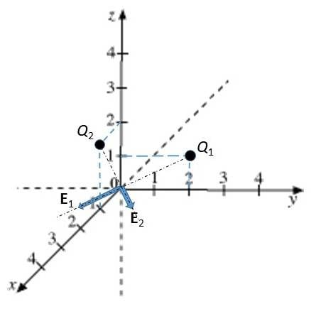

The first thing you should have shown here is a sketch of the problem (which is a requirement for the students in my class).
E1 is in the yz-plane, while E2 is in the xz-plane.
Next, are you able to write both E-vectors in their respective components? E1 only has y and z components, while E2 only has x and z components.
The resultant will be the sum of each individual components.
At this point, I'm not sure where you are along this step.
Zz.
Likes etotheipi and berkeman
I've the same sketch but it's handwritten and sloppy. Do you recommend any specific tool for those kind of sketches?
Anyway the problem has been solved, so thanks everyone! I used the method as ehild suggested at post number 5.
I suppose the E1 that are shown in the sketch could be written as the sum of the individual components which should be expressed using cos and sin and then divide it by the magnitude.
So for Q1 we get ; E = 2/sqrt(5) at the y direction and 1/sqrt(5) at the x direction. Does this look good?
I do have one last question though:
berkeman wrote;
"Just because the charge is sitting along the x-axis does not mean that it does not have a component of E-field along that axis... "
but ZapperZ then wrote;
"E1 is in the yz-plane, while E2 is in the xz-plane.
Next, are you able to write both E-vectors in their respective components? E1 only has y and z components, while E2 only has x and z components. "
I initially thought that E1 does NOT have a component on the x-axis since it is sitting on the axis. The two posts are giving conflicting information? (English is not my first language.)
The two posts are consistent. ##Q_{1}## is not sitting on the ##x## axis, it is in the ##y-z## plane. You know the field from this charge is going to be parallel to the line joining the charge and the origin, so evidently there can't be any ##x## component!
If the charge were to sit on the ##x## axis (for some reason...), there would only be an ##x## component at the origin.
Like @ZapperZ said, it's really important to consult diagrams to get a hold on the configuration.
When you say "sitting on the x-axis" do you mean the position of a charge Q is (x, 0 , 0)?
Yes. But it was only an example, it's not part of your question.
