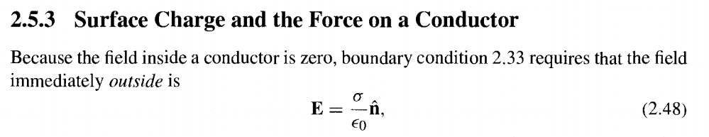

Griffith's says this, and I'm not exactly sure why...
If you had a solid, spherical, and externally induced conductor... Does this mean that IMMEDIATELY outside, when you're infinitesimally close to the surface, E looks like this? If you surround the entire conductor with a Gaussian surface (immediately outside, so not enclosing whatever's inducing the conductor), assuming the conductor is externally induced, wouldn't E = 0 because the net enclosed charge = 0? As you can tell, I'm confused.

Okay, thank you! I think I understand this better. But I'm still confused why Griffith's says E = δ/ε0n_hat immediately outside a conductor... Wouldn't this only apply for conductors that are infinite planes?

It's a general result, that at any discontinuity with surface charge density ##\sigma##, the normal component of the field undergoes a change of ##\sigma / \varepsilon_0##. Consider a tiny Gaussian pillbox that cuts through the surface, and suppose that the normal components of the fields on either side are ##E_1 \mathbf{z}## and ##E_2 \mathbf{z}##, where ##\mathbf{z}## is a unit vector normal to the surface [we can, here, ignore the tangential components (which are continuous), because they will not contribute to flux]. You have$$\int_{\Sigma} \mathbf{E} \cdot d\mathbf{S} = E_2 A - E_1 A = \frac{\sigma A}{\varepsilon_0} \implies E_2 = E_1 + \frac{\sigma}{\varepsilon_0}$$You can see that the normal component of the field has incremented by an amount ##\sigma / \varepsilon_0##.
At the surface of a conductor (of any shape!), the field inside is zero, so just outside some point on the conductor the field is going to have normal component ##\sigma / \varepsilon_0##.
With your example of an infinite, thin charged plane, say occupying the y-z plane, then the field on one side is ##- (\sigma/ 2 \varepsilon_0) \mathbf{x}##, whilst the field on the other side is ##(\sigma/ 2 \varepsilon_0) \mathbf{x}##. Notice that, again, the increment in the field is ##(\sigma/ 2 \varepsilon_0) \mathbf{x} - (- \sigma/ 2 \varepsilon_0) \mathbf{x} = (\sigma / \varepsilon_0) \mathbf{x}##.

When is a plane infinite? In this case, as in many other similar situations when you are doing physics, one should not imagine a mathematical infinity. Here "infinite" means "very large". Of course "very large" is meaningless unless you have a scaling distance to compare against. The idea behind the boundary condition is that it holds for any finite conductor if you are at a scaling distance ##\delta## above its surface that is very small relative to the local radius of curvature, ##R##. In the limit ##\delta\rightarrow 0## (##\delta <<R##), you are arbitrarily close to the surface which looks like an "infinite plane" much like the Earth looks flat when you are a meter or so above its surface.
