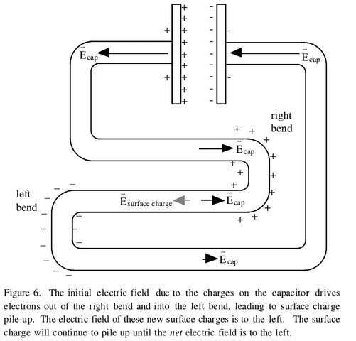

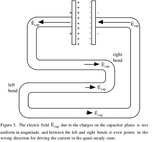

I've come across an instructive paper which explains qualitatively what happens inside wires of a simple circuit during the transient state, leading to the steady state where there is an uniform E field everywhere inside the wires.
Here are two figures from the paper which are pretty much self explanatory :
What I don't understand is that sentence from figure 6 :
"pile-up of surface charge will continue until the net electric field does point to the left"
Why does the pile up of charges continues even after the net field becomes 0 ? Why charges keep piling up until the E field reverses ? Shouldn't the pile up stops when the net E field reaches 0 ?
When the E field at one point reaches zero then, per Ohm's law, the current density at that point is 0. However if the E field is not zero at other points then there will continue to be current at those points which will lead to changes in charge at those points. The E fields from those distant points will continue to change the E field at the point where it is 0, even though there is no current at that point.

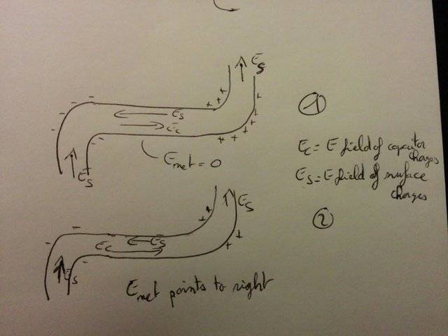

Thanks for answering Dale. Anyway I try it, I think I'm not understanding what you wrote correctly. When I try to imagine the scenario of charges moving, I end up with the net field pointing in the wrong direction. Here is a drawing that tries to explain it :
In the upper drawing, I imagine the net E field of the center wire of the previous figures to be 0. The net field is not 0 on the bends due to the surface charges having piled up. So around the bends, charges move again, but that move make the E field from the capacitor charges win again (lower drawing), with a net field to the right again instead of left.
It's not easy to explain sorry. And I'm sure I misunderstanding things, but can't see what I'm doing wrong.

To explain what troubles me precisely, let's say, in the following, that I am an electron located between the left and the right bend, in the circuit drawn on the paper (see figures in the OP). Let's also pretend electrons will move one by one during the transient state.
Here is what happens (we should all agree, I think, from step 1 to 5, then step 6 is my trouble) :
Step 1 (t = 0) : Right now, the net field is only due to the battery charges. Where I am located (between the bends), this net field points to the right. Thus, being an electron, I feel a force to the left. I move to the left bend.
Step 2 : I am now located at the left bend (somewhere at the surface). The left bend is a little bit more negatively charged due to me, and therefore the right bend is a little more positively charged. Thus, I "created" a small field to the left (the polarization field).
That small field of me will add to the field due to the battery charges, making the net field (polarization field + battery field) between the bends diminish in magnitude.
Step 3 : Another electron located between the bends move, as I did. Weakening a little more the net field to the right located between the bends.
Step 4 : As more and more electrons travel to the left, the net field between the bends -which still points to the right- is getting smaller and smaller and smaller in magnitude (because the polarization field -which points to the left- is getting stronger and stronger).
Step 5 : At some instant, there is so much electrons at the left bend, that the polarization field between the bends, which points to the left, is EXACTLY equal in magnitude to the battery field (that field never changed during the whole process). Thus, the net field between the bends now equals 0. At this particular instant, the polarization field and the battery field cancel each other at this "between the bends" location.
I would say so far this agrees with the paper and reality (apart from the fact that many electrons move simultaneously, not one after the other of course).
STEP 6 : Step 6 is my trouble.
Reality says : even more electrons will leave the location between the bends. They will move to the left, making the net field becoming not 0 again, but pointing to the left.
My head says : the net field between the bend is 0 now (from step 5). The electrons should NOT feel any force anymore. They shouldn't move anymore. Everything should stop. Equilibrium has been reached.Somewhere in this process, I must misunderstand something fundamental. Do you see it ?
I've just re read DaleSpam's initial answer, and got a better understanding of it. This might be it. He wrote :
Okay, so, let's say I'm at "step 5" (see my previous post). The net field where I am is 0. BUT, as Dale mentioned, there are other places in the circuit where the net field is not 0, charges are still moving there.
Therefore, it seems reasonable to think that the displacement of those charges, located somewhere else in the circuit, will affect the net field at the "between the bends" location (and everywhere else of course). Which solves the "why the net field doesn't end up being 0" question.
So all those little transient disorganised currents everywhere in the circuit continuously affect the net field anywhere, affecting the little currents, and so on and so on. When does this stops ? When the little currents are all synchronized ! Forming one only uniform current. Because only then, the net field is stable everywhere. => Steady state.
This seems to answer my question. Is that it ? Did I correctly understood your answer Dale ?
I Agree..Even if local field is 0, its not 0 everywhere at the same time. So the charges will still be moving and it will stop only when the E field inside is uniform.
Likes DoobleD
Yes, I believe so. I think that is as much of an answer that can be given without some heavy math.
