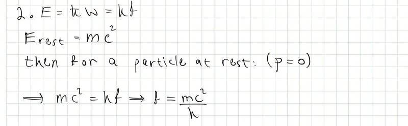

What's troubling me is how does a particle at rest has frequency different than 0, as you said w>0.
I'm attaching a file so you can see exactly where my problem is.
if lambda goes to infinity, doesn't frequency has to go to zero? As it does not in the attached photo.
Thanks a lot for the informative replies.
The plane-wave solution of the Klein-Gordon equation is
$$u_{\vec{p}}(t,\vec{x})=\frac{1}{\sqrt{(2 \pi)^3 2 E_{\vec{p}}}} \exp(-\mathrm{i} E_{\vec{p}} t+\mathrm{i} \vec{p} \cdot \vec{x}),$$
where I use natural units with ##\hbar=c=1##. The normalization is chosen in the relativistic covariant convention in QFT. The energy is given by the "on-shell condition",
$$E_{\vec{p}}=\sqrt{\vec{p}^2+m^2},$$
i.e., such that ##(p^{\mu})=(E,\vec{p})## transforms as a four-vector. For ##\vec{p}=0## you get ##E_0=m##. There's no problem with that. You can choose the absolute level of the energy as you like without changing any physics, and here it's convenient to choose it in this way such that ##(p^{\mu})## is a four-vector.
Not in general, no. For a photon ##\lambda \omega =c## so for them it is true that as ##\lambda\rightarrow\infty## we must have ##\omega\rightarrow 0##. But massive particles don’t have such a relationship so it isn’t a problem for massive particles. And massless particles can never be at rest so it isn’t a problem for photons either.
