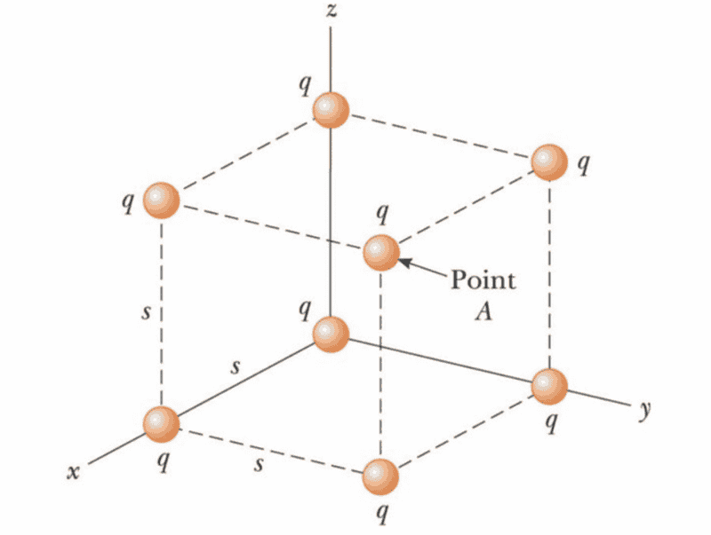

Eight point charges, each of magnitude q =4.76e-06 C, are located on the corners of a cube of edge s=14.8 cm, as shown in the figure. What is the magnitude of the resultant force exerted by the other charges on the charge located at point A? Image: https://drive.google.com/file/d/1mOFCbEIpWz8IohRbg-ZmnU2rn6VfZ7dS/view?usp=sharing
F=k*(q^2/r^2)
My first attempt at solving:
I divided up the point charges based on the radius away from point A.
1 charge was s*sqrt(3) away, 3 charges were s*sqrt(2) away, and 3 charges were s away from point A.
q remained constant.
Therefore, my F_total was:
F_total = k * [(q^2 / s^2*sqrt(3))+3(q^2/s^2*sqrt(2))+3(q^2/s^2)]
When I solved this, I got the wrong answer, unfortunately.
Can someone lead me in the right direction?
