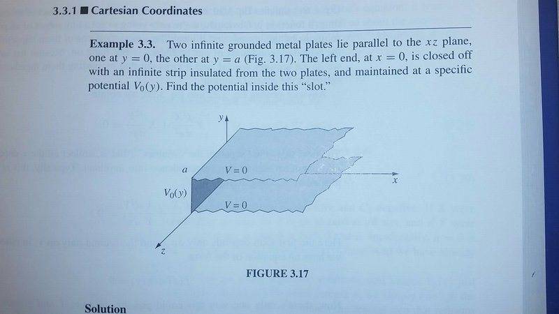

Boundary conditions are i) V=0 when y=0 ii) V=0 when y=a iii) V=V0(y) when x=0 iv) V=0 when x app infinity.
I understand and follow this problem (separating vars and eliminated constants) until the potential
is found to be V(x,y) = Ce^(-kx)*sin(ky)
Condition ii implies that V(0,a) = Csin(k*a) = 0 so sin(ka) must =0 and k=n*π/a
Question 1) Why can't we just set k=π/a so that V(0,y) = Csin(πy/a) where V(0,a) = 0 and V(0,0) =0? This would not screw up the boundary condition and you wouldn't have to deal with infinite solutions because of n?
