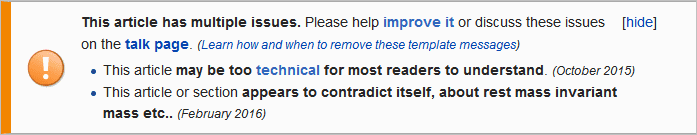

If it was... you did read this right at the top, correct ?

I agree that I should have paid attention to the wiki disclaimer that the site needs to be edited. Wiki seems to have usually been a good source of physics, so errors like this seem to me be rare. I could be wrong, though, I realize, based on this thread. If the general consensus on this forum is that wiki is not a good source of physics, is there some better website this forum accepts as valid physics in a similar encyclopedia format?
I don't see any error in this article.
