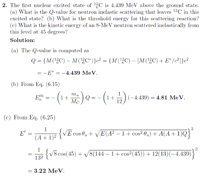

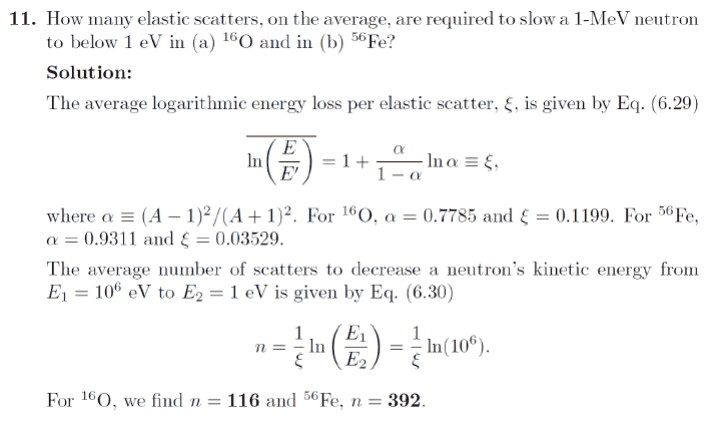

In our text which is what he references E' is something different: the elastic scattering energy
Reference:
This was mostly the same as our question:
Question more involving E':
I was using the E' formula for the first one because the formula the professor provided was:
n = ln(E_1/E_2)/zeta
instead of:
n = ln(E/E')/zeta
E_2 is not the same as E' here.

I suppose it is confusing for one to use E and E' in one case, usually the energy before collision and energy after collision, respectively, for a single collision, then for successive multiple collisions. In the context of the exercise, one can assume that one collision, or successive collisions are all elastic. For one collision, there is a defined relationship between E' and E in terms of the mass of the target nuclei and the scattering angle, and one could determine an average scattering energy by integrating over all angles. See equation (26) in the following link.
See some notes here: http://mragheb.com/NPRE 402 ME 405 Nuclear Power Engineering/Neutron Collision Theory.pdf
E and E' are variables, whereas E1 and E2 are particular values, and one could simply say, solve the problem when E = E1 and E' = E2, to which PeterDonis alluded. See equations (31) and (37) in the above link (and note E' and E'' are duplicated in the text before eq (37)).
It would be useful to work through the derivations and become comfortable with the theory.
