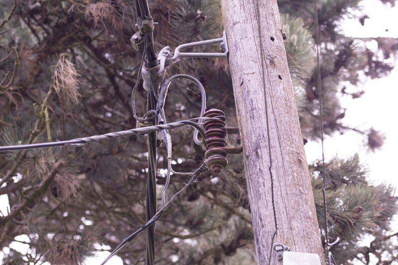

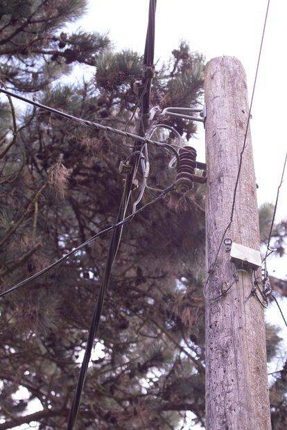

Take a good pic of the service head/cutout area and we should be able to identify the earthing system. Most likely TT in rural and older homes.

Hand held with a very bright sky - this is the best I could do.
Our supply is the nearer of the two. There seem to be two conductors going into the top left cable. But I also spotted a pair of bare conductors, strung from pole to pole beneath the supply. Could that be an Earth?
Note: I could see no connection between this extra pair and the power lines (on our pole or any nearby pole. And what could that box, connecting the pair together, be doing?

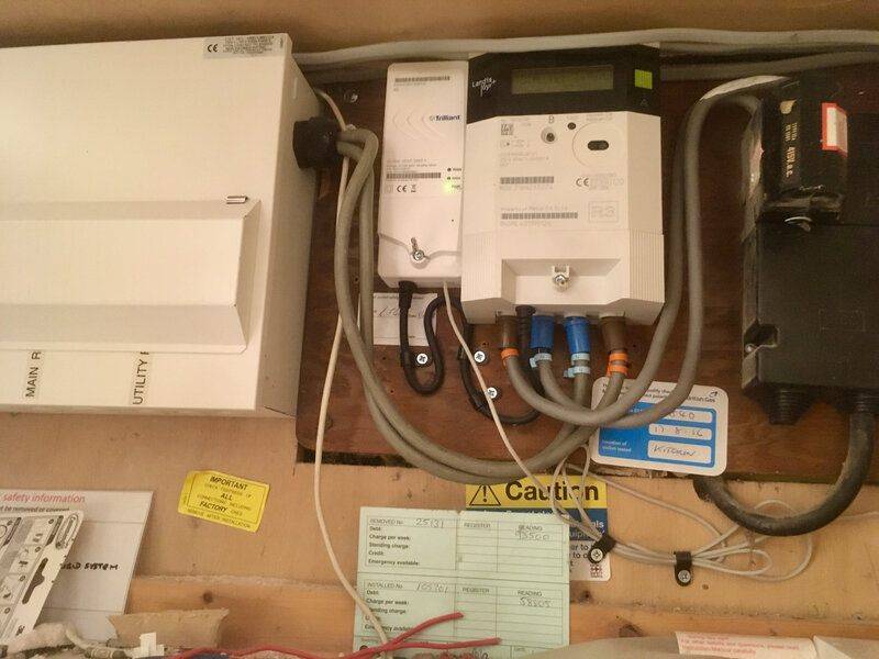

I actually meant the service head, ie where the supply comes into your house, where the large 100A (or whatever) fuse is.
Having said that, it certainly looks like you are not provided with an earth, therefore you have a TT supply. (Or maybe IT, if you’re in Norway;))
I can’t say for sure what the bare conductors are - but they certainly are at Earth potential, being tacked straight to the pole and uninsulated. Lightning conductors (possibly not)? Follow them to their origin!
Where the DNO provides a separate Earth conductor (TN-S), it’s usually derived from the lead sheath of the cable, rather than a dedicated wire.
If your Earth rod has a threaded top, you can buy a coupler, connect on another rod, and bang the lot down into the ground.
No sign of a third conductor emerging from the fuse holder block so you're probably right about TT.
Cop a load of the smart meter! Some people seem to have trouble but I've ben ok for about five years with ours.
