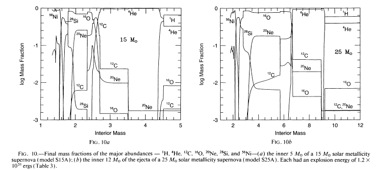

Here's the composition of core ejecta of SNe II stars:
(source: http://adsabs.harvard.edu/abs/1995ApJS..101..181W)
Everything below about 1.5 interior mass remains as the neuton core, hence the cut-off. You can see that the outer core is mostly He and H, the mid-inner range is dominated by oxygen, and the innermost is almost pure Nickel56.

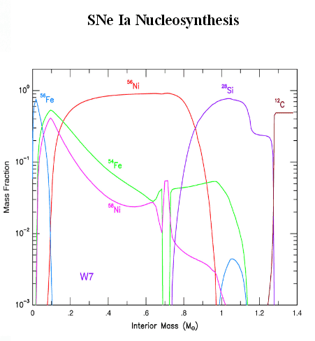

It's supernova type Ia explosions (SNe Ia - the exploding white dwarf companions in binary systems), however, that produce the most iron:
(source: http://www.int.washington.edu/talks/WorkShops/int_04_2/People/Truran_J/truransne1a.pdf)
The ejecta are dominated by Nickel56, 58 and Iron54, 56.
All graphs show only the most abundant elements. See the source material for details on the less-abundant elements.
Iron is thus the most abundant of heavy metallic elements in any interstellar gas cloud.

Look at the graphs - it's obvious that the most abundant metal ejected in SNe II is oxygen. SNe Ia, however, produce predominantly Fe and Ni, with some partially burned silicon and unburned carbon.

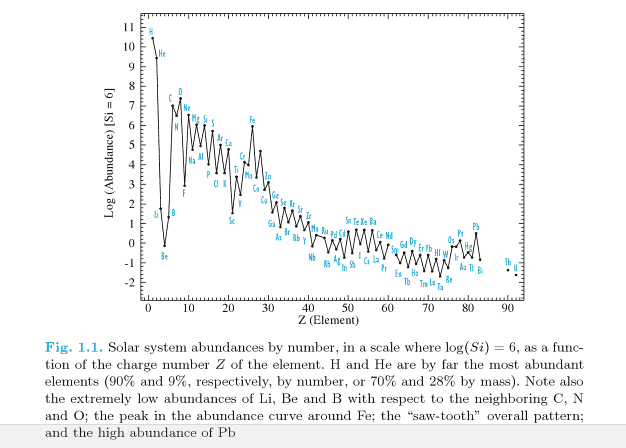

I'm not sure about this claim. The metallicity of the protosolar nebula is thought to be refleced in the metallicity of the Sun's photosphere:
(taken from Lectures in Astrobiology t.2; Gargaud, Martin, Claeys)
Si is then the fifth metal by abundance after O, C, Fe and Ne.
And is a "metal" only for astronomers. Back to chemistry - the metals are, in order of abundance, Fe, then Mg, Ni, Ca, Al. So the fifth metal in abundance is Al, not Fe.
Regarding that sawtooth pattern: note that odd elements also tend to have fewer stable isotopes. Does anyone have a distribution of isobars? For example, there is less Al in the world than either Mg or Si... because Al has a single stable isotope (27) while Mg and Si each have 3 (Mg has 24, 25 and 26, Si has 28, 29 and 30). What patterns would show if you look at the comparative abundance of all atoms by mass instead of charge?
