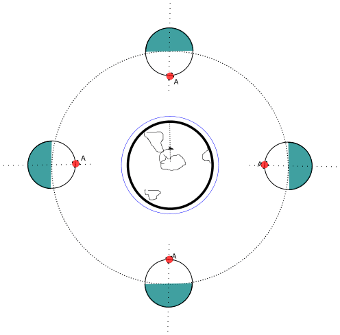

  • The moon rotates on its axis with the same angular speed as that which rotates around the Earth with parallel axes.
  • You neglect the effect of rotation with respect to the sun and only observe the factors dependent on the Earth and the Moon

The rotation results in another 0.001 % in addition to the tidal forces. That means that the effects discussed in this thread are negligible compared to the 0.6 % measured variations of the surface gravity (e.g. due to mascons):

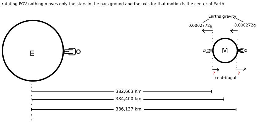

But the frame doesn't really matter, as long as we arive in the same conclusions:
The first conclusion is that my original post is wrong because i calc apparent weigth only based on gravity, therefore i find some very exagerated variations between the near and the far side of the Moon (that do not exist in the real world.
The second conclusion is that despite the above, there is space for smaller variations: It seems that the distance that we have from Earths core play some very subtle role in the apparent weigth in various locations on the Lunar surface (~0.003% between min and max ),
That would be just 0.5 miligrams difference in weigth (for a subject that originally weights 100kg on Earth), a negligible amount until someone states otherwise, for example a future Architect that will win a contract just because of that! xd

Why is there no rotation?
I see the red dot first on the left and then on the right of the moon, or vice versa, seen from a static earth, or first above and then below, or vice versa.

This is my derivation including the rotation:
In addition to the tidal forces mentioned in #10 there are also corresponding differences of centrifugal forces
##\Delta F_c = F'_c \cdot \Delta r = m \cdot \left[ {\omega ^2 \cdot \Delta r - \omega \cdot \left( {\omega \cdot \Delta r} \right)} \right]##
in the co-rotating frame of the Earth-Moon system. Depending on the location of the moon in the rotating frame there might be a term ##\omega ^2 \cdot r## in the equation for the centrifugal force ##\Delta F_c## but not in the gradient ##{F'}##.
Neglecting the displacement of the center of Earth with respect to the center of mass results in the approximation
##\omega ^2 \approx \frac{{G \cdot M}}{{\left| r \right|^3 }}##
for the angular velocity. With Earth and Moon on the X-axis and the definition of longitude and latitude from #11 the total variation of the appearent weight is given by
\Delta F = \Delta F_g + \Delta F_c \approx \frac{{G \cdot M \cdot m}}{{\left| r \right|^3 }} \cdot r_M \cdot \left( {\begin{array}{*{20}c}

As @Charles Link pointed out:
The motion of a point on the Moon's surface is a circle centred on the Earth/Moon barycentre. The (real) acceleration is, therefore, simply the centripetal acceleration associated with this orbit. There is no additional acceleration associated with the motion relative to the centre of the Moon.
Likes Richard R Richard
  • #31
If you look at the red dots and continue them through the whole circle, you will see they are doing circular motion about the center of the earth. Yes, the moon has a rotation whose period is the same as its period of revolution, but that rotation simplifies this problem, by making the motion of the object simply as a circle around the earth.
The object is lighter than the gravity by the moon, because the period of its orbit is determined by the time ## T ## that the center of the moon orbits. ## F_{gravity \, earth}=GMm/(r-\Delta r)^2## , while centripetal force needed is ## F_c=[(2 \pi (r- \Delta r)/T]^2/(r- \Delta r) ##, with center of moon in orbit obeys ## GMm/r^2=(2 \pi r/T)^2/r ##. The difference between the Earth's gravity and the centripetal force needed is how much lighter the scale reads from the gravity of the moon pulling on the object.

[QUOTE = "PeroK, post: 6435672, member: 493650"]
$$ N_f = F_M + F_ {cMc} $$
And the effective gravity on the Moon depends on which side you are standing on?
[/QUOTE]
You're right, maybe I mix ideas, actually on the opposite side in the same frame of reference I must have written something like
[tex] -N_f = -F_M + F_ {cMc} [/tex]
That is, when we include the Earth
[tex] N_c = F_M-F_ {Ec} F_ {cEc} -F_ {cMc} [/tex][tex] -N_f = -F_M - F_ {Ef} + F_ {cEf} + F_ {cMc} [/tex]
Which are the same equations, but the sign only indicates the vector sense in that frame of reference.
Actually, the difference between the measured values between one side and the other is due to the difference between
$$ F_ {Ec} - F_ {cEc} \neq F_ {Ef} - F_ {cEf} $$
