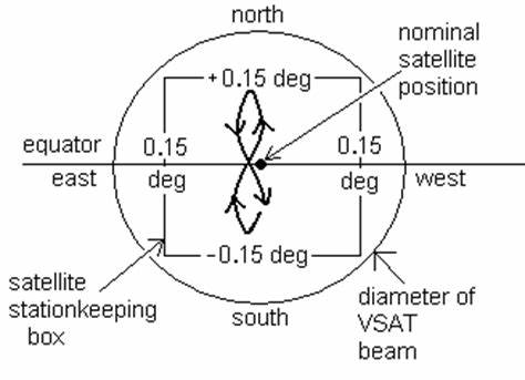

They do oscillate a little north and south of a fixed point on the Earth's surface
Other than that, they rotate with the Earth. If they didn't, Satellite TV and other comms wouldn't be possible through themDave

Also, @John12343210, in regard to your original question, gravitational forces are continually tending to move the satellites out of position so that thrusters must be used to counteract this tendency. I understand the fuel load is what generally determines the effective lifetime of such satellites. The process is known as station keeping.
