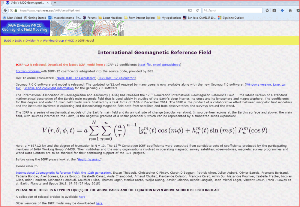

I want to render the Earth’s Magnetic field in a software and simulate solar wind electron interaction with it. How do I calculate the magnetic strength and vector orientation at each point around the Earth up to thousands of km?
Is there a formula?
Or do I need to download a vector field from NASA?

I started skimming down the references in the linked article, clicking into a few, and then clicked into Lucky #13.
That landed me in a long list of FAQs about the subject, and seemed to be pointing to several models of the Earth's geomagnetic field. I started seeing that there are several models that are used, and data and simulations for each. I didn't spend a lot of time looking, but clicking into FAQ #4 about how to get some of the model coefficients got me to a page with one possible equation to use. You might see if you can base your simulations off of that equation, to get some preliminary data. You will also need to get some sort of data or model of the Solar Wind, I would think.
You may want to spend some time clicking through the different models that are mentioned in the FAQ list -- that should help you to understand more about how the geomagnetic field is modeled.
