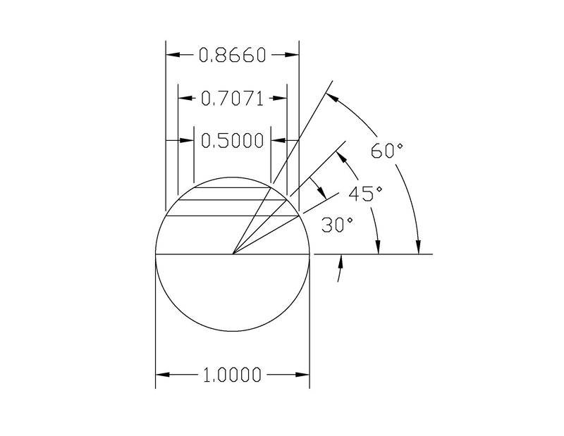

Also. For a sphere with a circumference of 1 at its equator, what would be the circumference of the 30 degree, 45 degree, 60 degree north circles of latitude?

... Also. For a sphere with a circumference of 1 at its equator, what would be the circumference of the 30 degree, 45 degree, 60 degree north circles of latitude?
Excellent! Thank you much! By the way, what would the value be for 15 degrees north?
You are welcome.
For 15 degrees north the value would be simply 1.0 x cos (15) = 0.9659.
