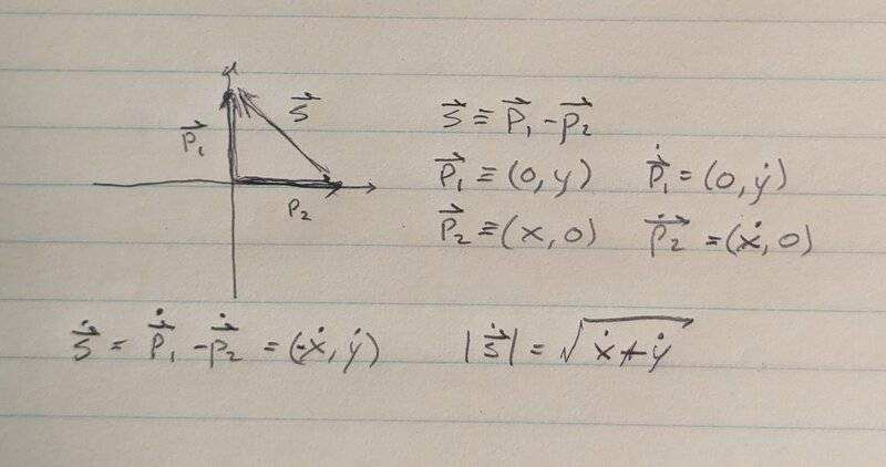

The problem lies with Pythagoras and derivatives. Any distance function of the form ##s=\sqrt{f(x,y)}## will have ##\dot{s} = \frac{1}{2s} \dot{f(x,y)}##
If you treat everything as vectors you get this:
Which is your original geometrical argument. It's not singular, but if you want to know ##\dot{s}## at (0,0) you have to figure out what ##\dot{x}## and ##\dot{y}## are there. Which should be simple DEs. Like parameterizing with time. You would have to do that anyway with the other formula to know what ##\dot{x}## and ##\dot{y}## values to enter at any point.
I'm stuck with the algebraic approach.
edit: Oops, typo: I left out the squared part ##\dot{s} = \sqrt{\dot{x}^2 + \dot{y}^2}##
