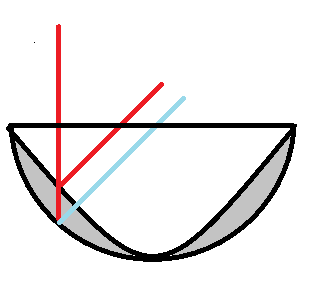

I imagined a difference of phase λ/2 on the blue ray.
The grey is the air maybe polluted, as currently

Please show us your work. Did you take into account any phase shifts due to reflections?
OOps
I thought that can the error is in the reflections yes.

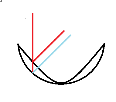

t is the thickness, that is, the difference of path, but:
2t = (n-1/2)λ
where the half is the difference of phase.
To be more specific, the red ray will reflect first without change of phase, and a part of it will be transmitted.
In this transmission, it will suffer another reflection, but this case the difference of refraction indice will make a difference of phase λ/2 (here i am a little confused if is λ/2 or λ
If a reflection causes a phase shift, it will be a phase shift of ##\lambda/2##. Yes, there is a phase shift at the second reflection but not at the first reflection.
Keep in mind that you are dealing with the dark rings.
