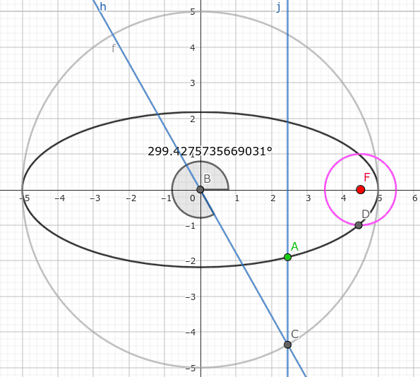

I want to calculate eccentric anomaly of all points of ellipse-circle intersection.
Ellipse is not rotated and its center is in origin.
Circle can be translated to (Cx, Cy) coordinates.
I am using python for calculations.
Only solution I found, is this:
https://math.stackexchange.com/questions/3419984/find-the-intersection-of-a-circle-and-an-ellipse
And I implemented it in my code. I avoided calculating polynomial roots manually by using numpy's solver.

I tested it on some simple example:
>>> ellipse_circle(5, 2.17945, 4.5, 0, 1)
array([5.22599703, 1.05718828])
But those two roots are not eccentric anomalies of intersection points, as can be seen here (Point D is real intersection, and point A is calculated one):
So, what am I doing wrong, how can I calculate eccentric anomaly?

You are calculating values for the parameter [itex]z \in \mathbb{R}[/itex] in the parametrization of the circle [itex](x-x_c)^2 + (y-y_c)^2 = r^2[/itex] as
[tex]\begin{split}
x = x_c + r \frac{1 - z^2}{1 + z^2} \\
y = y_c + r \frac{2z}{1 + z^2}. \end{split}[/tex] [itex]z[/itex] is not an angle, so I do not think it is necessary or correct to return these modulo [itex]2\pi[/itex], as your program does (see line 20). Replace line 20 with
Python:
   return real_roots
and see if it does any better.
EDIT: Note that the point [itex](x_c - R, y_c)[/itex] is attained only in the limit [itex]|z| \to \infty[/itex]; this corresponds to the coefficient of [itex]z^4[/itex] vanishing. You can test this case by setting cx = -0.5, cy = 0, r = 0.5, a = b = 1.
I also now see from your diagram that you have misinterpreted the root 5.22 as being an angle in radians about the origin (5.22 rad ~ 299 deg); it is not. You need to use the above parametrization of the circle to recover the x and y coordinates. The eccentric anomaly can then be calculated as [tex]
\arccos\left(\frac{1}{\sqrt{1 - b^2/a^2}}\left(1 - \frac{\sqrt{(x-ae)^2 + y^2}}{a}\right)\right)[/tex] as shown here.

I had no idea that parameter is from circle.
I thought that parameter ##z## is same as parameter ##t## as used in normal parametric equations.
Here is working code if anyone in future needs it:

Note: because of square roots in line 23, calculated angle is in range (0, ##\pi##), which is corrected in line 24.
Resulting eccentric anomaly is in range (0, ##2\pi##).
In my simulation it is very unlikely that this edge case with ##z^4## coefficient being zero will occur, so I just omitted it to save computation time.

Thinking again, it is simpler to obtain the anomaly from [itex](x,y)[/itex] as
Python:
np.arctan2(np.sign(y)*np.sqrt(a**2 - x**2),x)
since the auxiliary circle of the ellipse is [itex]x^2 + y^2 = a^2[/itex].
EDIT: Simpler still is
Code:
atan2((a/b)*y, x)
since [itex](x,y) \mapsto (x,(a/b)y)[/itex] maps the ellipse [itex](a\cos\theta, b\sin \theta)[/itex] to the circle [itex](a \cos \theta, a \sin \theta)[/itex].
Likes Marko7
A further refinement is to parametrize the ellipse, rather than the circle, as [tex]\begin{split}
x &= a\frac{1 - z^2}{1 + z^2} \\
y &= b\frac{2z}{1 + z^2} \end{split}[/tex] and then the values of [itex]z[/itex] at the points of intersection are the roots of [itex]P(z) = \sum_{n=0}^4 a_nz^n = 0[/itex] where [tex]
\begin{split}
a_0 &= a^{2} - 2 a c_{x} + c_{x}^{2} + c_{y}^{2} - r^{2} \\
a_1 &= - 4 b c_{y} \\
a_2 &= - 2 a^{2} + 4 b^{2} + 2 c_{x}^{2} + 2 c_{y}^{2} - 2 r^{2} \\
a_3 &= - 4 b c_{y} \\
a_4 &= a^{2} + 2 a c_{x} + c_{x}^{2} + c_{y}^{2} - r^{2}
\end{split}[/tex] The anomalies are then obtained by
Python:
    np.atan2(2*z, 1.0 - z**2 ) for z in roots if np.isreal(z)
with the addition of [itex]\pi[/itex] if the degree of [itex]P[/itex] is less than 4.
