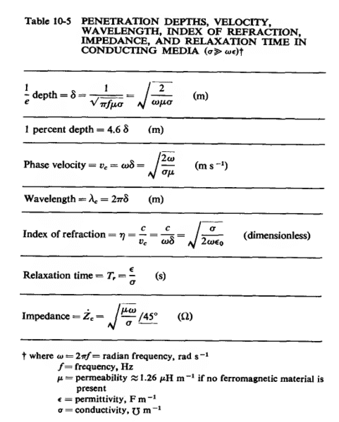

Skin effect has been factored into the calculations. Braking is higher at higher speeds, but only because force depends on velocity directly and the skin effect does not cancel out the higher force from the higher velocity. Skin effect does decrease the force generated. It is a function of velocity; it's used to find the frequency of the magnets, which are then used to calculate skin effect.
It is important to understand what really causes the skin effect. A good conductor is highly reflective because the counter-current induced by the magnetic field in the surface cancels almost all the incident field.
The surface current therefore diffuses into a good conductor at a very low velocity, something of the order of 100 m/s. If the source of B travels faster than that figure, the magnetic field will be reflected from only a very thin layer on the metal surface before it is left far behind by the traveling source of B.
See attached.

Yes, maglev trains do use eddy current braking. The field diffusing into the rail generated by the front of the train will continue to build up while the train passes and so will be available at the tail.
On the other hand, a short vehicle is unable to use the full thickness of the rail because it has passed before the field can diffuse far into the rail.
