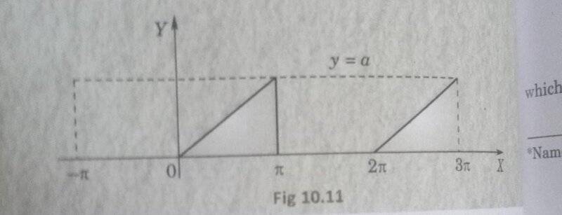

So I basically saw this graph specified as a particular waveform in my book while reading Fourier Series. I decided to try and derive its function since once I do that I can easily find the FS. Please find the photo and my attempt below, just need a small confirmation if I'm right/wrong.
So I thought that the graph tries to tell us that the function is periodic after 2π interval. So I tried to derive its function from the graph as follows using the point slope equation form for the points (0,0) & (a,π): ##y= ({a}/{π})*x##
I hope this function is alright and I just need to find its Fourier Series

Actually the graph shows
##y=\frac{a}{\pi}(x-2n\pi)## for ##0<(x-2n\pi)<\pi## for integer n
y=0 for others.

Oh I see. Now I realize how you have represented it an even general manner. Although I am a bit confused now, how should I find FS for the same, I mean I'm confused about the intervalbin which integration for FS will be carried out..
Because the function, say f(x), has period of 2##\pi##, it is expressed as
f(x)=\frac{a_0}{2}+\sum_{k=1}^\infty (b_k \sin kx + a_k \cos kx)
You may calculate ##a_k## and ##b_k## in a usual way.

Thank you so much! Now I get it🙏🏻
