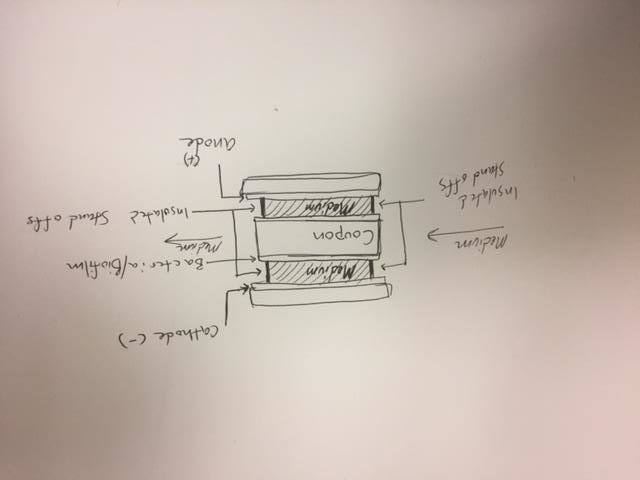

So, I did an experiment where I had a TENs device with some adhesive electrodes. The idea was just to see if I could kill bacteria using a TENs 7000 Unit and a med range setting. I measured out with an oscilloscope the average voltage wave (pulsating square wave) at 50 Volts. The time duration of experiment was 60 minutes, the rate of frequency was 5.0 Hz, and a pulse width of 100 micro S. The outcome with this experiment was that with, or without the device on I killed bacteria. I wondered why, and I realized that these adhesive pads which are about 1" by 1" where naturally antimicrobial. The next experiment I used the same settings on the TENs device, and eliminated the electrode pads by using the metal conductors without attaching the probes. It will inevitably have a greater current density at a more localized point where it made contact with the bacteria. Therefore, I thought I would see an excess amount of kill around the electrode probes, and maybe an arced line of kill connecting the probes, but in the end I didn't have any kill, and the results were inconclusive.
This is why I want to confirm I am actually making a connection through the medium/bacteria so I am hitting them with the current. All of the papers I have read have listed a wide range of parameters for killing bacteria in their experiments, but I think I have settled on just trying the lowest direct current I can achieve a successful kill with.
I have a new experimental idea involving electrodes at a fixed distance inserted into a flowing medium where the surfaced attached bacteria are located directly in between the two probes, but not touching the electrodes. I will attach a copy of sketch I made for this experiment, please tell me what you think, or how I should revise it.
Also the picture may be upside down.
Still - I am more suspicious of the metallic ions you put into the sample than the current itself.
I am checking with an expert on this...literally.

OK. Let me know what you and your expert think on this one. I am currently in the process of mapping out current levels in relationship with distance of some Tripic Soy Broth. I have measured out a petri dish with .5 cm marking across the diameter of the dish which will indicate where I play my probe.
OK - you asked. It helps to have a microbiologist brother...

Well, this is beyond helpful, and thank you and your brother for all of the insight on this project. I want to inform you of my experiment yesterday and my results.
As I had mentioned I was going to run an experiment with a simple programmed Arduino to output between 0 - 5 V using a keypad. I only used an output of 5 V for this experiment,
Vin (5V) ---- 1k Ohm resistor ----- 1.3 V drop Blue LED ------- Tryptic Soy Broth Medium ----- Multimeter to measure current ---- GND
I measured out a small amount of TSB into a petri dish, and measured the diameter of the petri dish (8.7 cm), and marked .5 cm across the length of the petri dish where I would move my probe to measure current at various marked distances .5 cm's away from one another. I made a make shift Aluminum foil probe measuring 1.2 cm across which was stationary at the 0 cm mark, and the other probe was a stainless steel probe from the multimeter. I essentially used a method called 'spot sampling' across the length of petri dish and noted down the current at 5 V at different distances 0 - 8.7 cm.
I then removed the resistor and LED and ran straight 5 V into my TSB, and did the same exact experiment. What I found though was that galvanic corrosion had been taken place on the Aluminum foil and in relatively short time I had eroded the stationary probe away. Looking under a microscope I could see this happening.
Today I will experiment with different probe materials. The first one will be a carbon fiber thread. I will take apart the original adhesive electrode I used in previous experiments and strip it down to the carbon thread material lining the inside of the square pad, and see if I experience any galvanic corrosion with this in such short time.
I do think I have been successful in achieving a steady draw of current in this experiment. When I get my hands on some more bacteria I will be able to kill bacteria using only 5 V, as the most current I had drawn across the medium was only 33 mA when the probes were .2 cm away from each other. Other researchers had observed bacteria kill at 500 micro A. I can then limit current even further by adding more resistors in series with this experiment.
