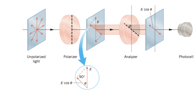

This is problem 62 in Cutnell & Johnson's Physics (9th edition):
Suppose that the light falling on the polarizer in the figure is partially polarized (average intensity [itex]\bar S_P[/itex]) and partially upolarized (average intensity [itex]\bar S_U[/itex]). The total incident intensity is [itex]\bar S_P+ \bar S_U[/itex] and the percentage polarization is [itex] 100 \bar S_P/(\bar S_P+ \bar S_U)[/itex]. When the polarizer is rotated in such a situation, the intensity reaching the photocell varies between a minimum value of [itex]\bar S_{\min}[/itex] and a maximum value of [itex]\bar S_{\max}[/itex].
Show that the percentage polarization can be expressed as [itex] 100 (\bar S_{\max}-\bar S_{\min})/(\bar S_{\max}+\bar S_{\min}) [/itex].
I might not be understanding what the problem is asking, but I'd say that the proposed solution cannot be true.
The minimum intensity reaching the photocell as the polarizer is rotated is clearly zero, isnt'it? This correspond to the polarizer axis perpendicular to the analyzer axis. Whatever goes through the polarizer emerges polarized along its axis. When it subsequently hits the perpendicular analyzer it is completely blocked.
The maximum intensity happens when the polarizer axis is parallel to the electric field in the incident polarized component. In this situation the whole polarized component is transmitted, along with half of the unpolarized component. Whatever [itex]\bar S_{\max}[/itex] is, the solution proposed by the problem gives 100%, which does not make sense.
If I look at the intensity emerging from the polarizer only (and therefore not hitting the photocell yet) I get
[tex] \bar S_{\max} = \frac{1}{2} \bar S_U + \bar S_P \qquad \bar S_{\min} = \frac{1}{2} \bar S_U [/tex]
In this case, I get the expected result, because [itex] \bar S_{\max}+\bar S_{\min} =\bar S_P + \bar S_U [/itex] and [itex] \bar S_{\max}-\bar S_{\min} =\bar S_P [/itex].
Another possibility is that the polarizer and the analyzer are rotated so that the angle between their transmission axes remains the same.
In this case
[tex] \bar S_{\max} = (\frac{1}{2} \bar S_U + \bar S_P) \cos^2 \theta \qquad \bar S_{\min} = \frac{1}{2} \bar S_U \cos^2 \theta [/tex]
and the proposed solution also applies.
Maybe this is because I'm not a native English speaker, but it seems to me that the text of the problem states that the polarizer is rotated, while it should say that both the polarizer and the analyzer are rotated by the same angle, so that the angle between their axes stays constant.
Does this make sense?

I have a different interpretation.
Start with the system shown in the figure except that the incident light on the polarizer is partially polarized and not unpolarized as the figure says.
Let the intensity incident on the polarizer be ##\bar {S}_u+\bar{S}_p.## The question is what is the intensity emerging from the polarizer? I note that the polarized component of the incident light need not be along the axis of the polarizer. The emergent intensity will be $$\bar {S}_1=\frac{1}{2}\bar {S}_u+\bar{S}_p\cos^2\!\varphi$$ where ##\varphi~##is the angle between the initial polarization and the axis of the polarizer. Now all this light is polarized along the axis of the polarizer. If the angle between that axis and the axis of the analyzer is ##\theta##, then the intensity incident on the photocell is $$\bar S=S_1\cos^2\!\theta=\left(\frac{1}{2}\bar {S}_u+\bar{S}_p\cos^2\!\varphi\right)\cos^2\!\theta.$$This has a maximum and a minimum value depending on the value of ##\varphi##.
The problem is asking you to show that you can figure out the percentage polarization of the partially polarized light simply by measuring the maximum and minimum values at some arbitrary (but fixed) value of the analyzer relative to the polarizer.

My interpretation in post #5 did not express clearly what I was in my mind and I can see why it is confusing to someone who cannot read my mind. When I wrote " ##\dots~##at some arbitrary (but fixed) value of the analyzer relative to the polarizer" I meant that the analyzer is fixed relative to some direction in the lab so that the polarizer has a continuously changing angle relative to it.
One does not have to rotate the polarizer and analyzer together for the formula to be valid and one is expected to show that. Although ##(\bar S_{\max}+\bar S_{\min})## and ##(\bar S_{\max}-\bar S_{\min})## depend on the direction of the analyzer, their ratio, and hence the percentage polarization, does not. That is the point of this problem, I think.

That's what I mean. Let me explain some more.
Look at the drawing. There are dotted lines on the polarizer and the analyzer to indicate axis of each. The dotted line on the polarizer is along the vertical. The dotted line on the analyzer forms angle ##\theta## from the vertical. Now rotate the polarizer away from the vertical but keep the analyzer fixed at ##\theta## and find the maximum and minimum intensity at the photocell. Clearly, the number for the maximum and the number for the minimum recorded by the photocell will depend on the value of ##\theta##. The problem asks you to show that the formula works regardless of what ##\theta is.

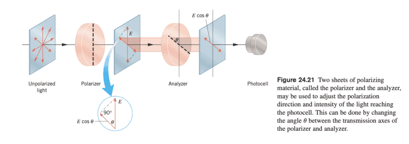

Hi,
i copied the text basically verbatim. I just did not copy the reference to the figure.
The figure I included in my OP is indeed figure 24.21. This is at page 755, in the theory part.
The text of the exercise specifically refers to that figure, as far as the configuration of the analyzer-polarizer system is concerned.
Below I'm attaching the original text of problem 62 (page 767) and the complete figure 24.21.

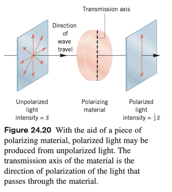

Now I think I see what you mean... It might be a misnumbering of the relevant figure.
Probably the author of the problem did not mean figure 24.21, but rather figure 24.20, which I'm also attaching below.
Now that makes sense...
I should have thought of that :frown:. The fact that the term "polarizer" is introduced in figure 24.21 is slightly misleading, though. Also maybe I would call the sheet of polarizing film used for in problem 62 an analyzer rather than a polarizer. But I think I'm nitpicking.

Yes, a typo almost explains it. But note the text refers to a photocell, and there is none in 24.20. So I'd say the author tried to get away without drawing another diagram.
I think you are correct and nobody picked up the error. The 9th edition was out in January 2012. It would be informative to see if the most recent edition has this problem and in a corrected form.
Hi all,
I discovered that the book comes with an Instructor's Manual. I asked around and someone provided the "official" solution to problem 62.
The "reasoning and solution" seems to indicate that there was no error in referring to fig. 24.21. The reasoning never explicitly mentions this, but kind of confirms that the polarizer and analyzer are rotated together by the same amount. Indeed the calculations are exactly as in the second scenario in my OP, in that both the maximum and minimum intensity are proportional to [itex]\cos^2 \theta[/itex].
If there was only one polarizing sheet, like in fig. 24.20, there would not be such a factor (like in my first scenario).
Also, as @haruspex observes, the text of the problem explicitly mentions a photocell, which is present in fig 24.21 and absent in fig. 24.20.
I'd be curious to see whether more recent editions clarify that the polarizer and analyzer must be rotated together. I do not think that this is obvious from what is explained in the book: for instance, the caption of fig. 24.21 explicitly says that [itex]\theta[/itex] changes. This is confusing for a student, I think.
After all this seems to be one of those problem that is immediately clear only to people whose job is inventing textbook problems.
