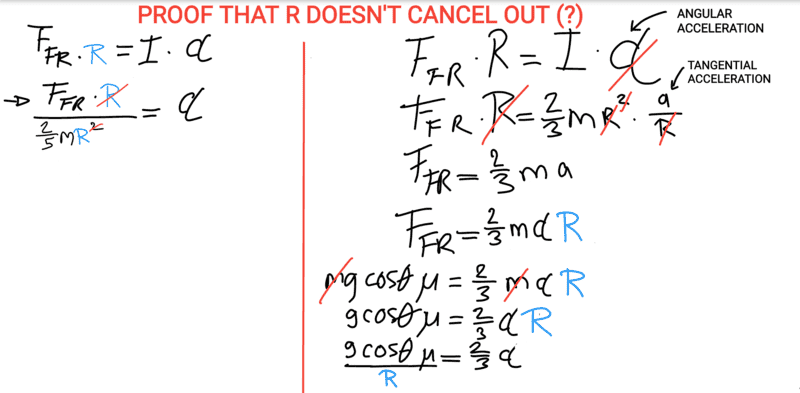

First of all, thanks everybody for the directions. Hereunder my refined assumptions based on your input:
Regarding the relationship between torque and moment of inertia: @haruspex Applying your analogy to my topic question, it would mean that the torque should be seen as a constant (?) and that, therefore, the angular acceleration must get smaller when the moment of inertia gets larger. Just like the amperage becomes smaller when the resistance increases at a constant voltage supply, in your example
V = IR
50 v = 5 A *10 Ohm
50 v = 2,5 A * 20 Ohm
Also, I tried rearranging the my initial torque formula to see if it could help me in arriving at a logical conclusion: Dividing both sides by “I” left me with “Ffriction*R / I = angular acceleration” or, put differently, “Ffriction/I + R/I = angular acceleration. Am I correct in saying that another way of stating this is that angular acceleration is inversely proportional to “I”? Thus, an increase in “I” would mean a smaller angular acceleration. This is also in some way in accordance with the analogy that @haruspex provided. Am I concluding it correctly so far?
Regarding mass and volume: at the meantime I continued with searching on rotational inertia and found out how the mass (indeed) cancels out and has no effect on the other side of the equation when you substitute angular acceleration with “tangential acceleration / R” and subsequently Ffriction with “μ*Fnormal”. I also saw that the radius also cancels out and thus volume should not have any effect on angular acceleration too. Thanks you for your view @Delta² ; seeing it from a proportionality point of view helps a lot.
On the whole, if all my conclusions above are correct, I see the relationship between rotational inertia and angular acceleration, and also see that mass and volume is of no effect.
Last, but not least, regarding my assumption about the distance that each ball will cover after having reached the bottom: Now, the last thing I wonder is, if I am right in saying that both balls with a different density will also cover the same distance because of the above mentioned conclusions; hat the weight is larger, will also mean that the friction force will be larger, resulting in a the same angular acceleration for both balls and an equal distance being covered.
Awaiting your replies. Thanks in advance.

@Delta²
The effect of R on angular acceleration and covered distance
It tried proofing myself what the effect of R is by doing the following: (Please see right side of picture.) First, I substituted the “tangential acceleration” with “angular acceleration*R”. I rearranged the formula such that R got at one side. It seems to me that the fact that R can be put at one side of the eventual formula and that it cannot cancel out, is the evidence that R must have an effect on angular acceleration. Conclusion: it should have an effect. However, also here, it seems to be me that it isn't possible to conclude straight away what the exact relationship between the variables is as there, again, are three variables. Therefore, I get hung at proofing mathematically that a larger radius will cause a larger acceleration and a larger distance coverage.
Something I fail to get is, if volume has no effect, how does radius do? Say the volume increases, then, the radius must also become larger. So, both volume and radius should have an effect, just the fact that volume is not used in the formulas should be what's different then, shouldn't it? Or is there something I fail to see?
And lastly, I have watched an experiment of prof. Lewin in which a disc with a larger radius reaches the bottom at the same time as one with a smaller radius; since the theory behind discs is (as far as I know) the same for spheres, it seems to me that this contradicts the idea that the radius should have an effect ().

OK sorry I was wrong, R doesn't affect tangential acceleration but it affects angular acceleration. But be carefull on what's happening after the rolling on the inclined has ended, friction alone can't make the rolling sphere stop on the horizontal plane.
