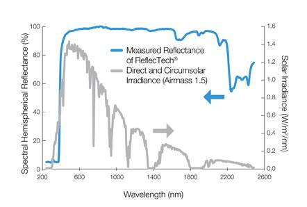

I'm needing to reflect additional solar into a greenhouse to increase plant beneficial PAR light (400-700nm) while restricting and minimizing excessive IR heat also building up inside, too.
I'll be using 400 sq ft of flat plate reflectors (40'X10') at ground level horizontally positioned along and outside the southern facing vertical clear poly walls of the greenhouse.
These rigid flat reflector surfaces will be topped with a specular mirror finished poly film, specifically http://www.reflectechsolar.com/technical.html
If compatibility tests first confirm no issues (manufacturer said should be OK), I intend to then next topcoat apply onto reflective film this liquid nano IR blocker product here... https://drywired.com/wp-content/uploads/2015/06/Liquid-NanoTint-PDS.pdf
Which claims to block/absorb a significant portion of the NIR and Far IR heat producing portion of the solar spectrum when applied to windows.
My question is, of the light then reflected and exiting this reflective combo, what might specular degradation and transmittance %'s and IR absorption %'s all look like after those incident solar rays had passed through that nano top coating twice?
Is it reasonable to just cut performance values in graph above in half for rough idea of the effect to be expected, or is there likely other and additional effects to also be considered here now? (Besides expecting absorbed IR heat should be greater on treated reflector and its substrate than a window that only gets a single pass.)

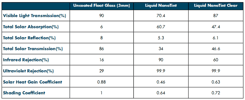

This might be a better way to ask what I'm inquiring about here...
How do you feel the two columns of values on the right in the following chart of the IR absorber NanoTint would change with incident solar reflecting off of 94% mirror film causing then two passes through the NanoTint instead of single pass that's being represented here...

Since your IR blocker is a coating, and non-directional, I would think that your initial idea was right, and the IR gets rejected twice; 90% on the first pass, and some significant amount of the remaining 10% on the way back. What happens to this second set of IR waves is difficult to predict, since I don't know exactly how the coating works. They may get reflected back down at your mirror, which reflects them back up again and so on. This would result in the IR bouncing back and forth between the two layers with the nano coating letting 10% through every time, until it all gets passed. Not a big deal, since it's only 10% of the original value, to begin with.
However, the temperature inside your greenhouse is still likely to rise significantly. You might have more knowledge than I about the way greenhouses work, but as I understand it, the clear walls already block most IR and allow light in the visible and UV ranges to pass freely. These frequencies are then absorbed by the plants and other objects inside, which convert them to IR. That IR is then blocked from escaping. It is this heat energy, radiating from objects within the greenhouse, that is chiefly responsible for the increased temperature inside. So anything you do that increases the amount of visible light entering the greenhouse will also cause an increase in temperature.
If this is true , then you might be better off skipping the IR blocker, and looking for ways to vent the excessive heat. Just something to consider.

Thank you for your comments, Lurch.
I'm in conversation with tech guys from NanoTint and awaiting more feedback from them as they had not explored using it this way, essentially as a top coat to a mirror then generating two passes, but they did confirm it works in either direction the same as it's via absorption, not reflection. I'm hoping to hear from them what they think it'll do to the numbers overall and to the specular nature of the incident rays striking the mirror finish, how much we'd lose to diffusion scattering and all.
As far as the greenhouse poly film walls, it's like a car with windows up on a sunny day, shortwave solar radiant heat readily passes through them, then it's absorbed by everything inside to the degree that it's non reflective and they then re-radiate as long waves that the windows or poly film then won't let so readily pass back out. Those heated up materials in there in turn heats up the air inside.
Minimizing that initial IR getting in, while still maximizing plant needed PAR 400-700nm, is job #1.

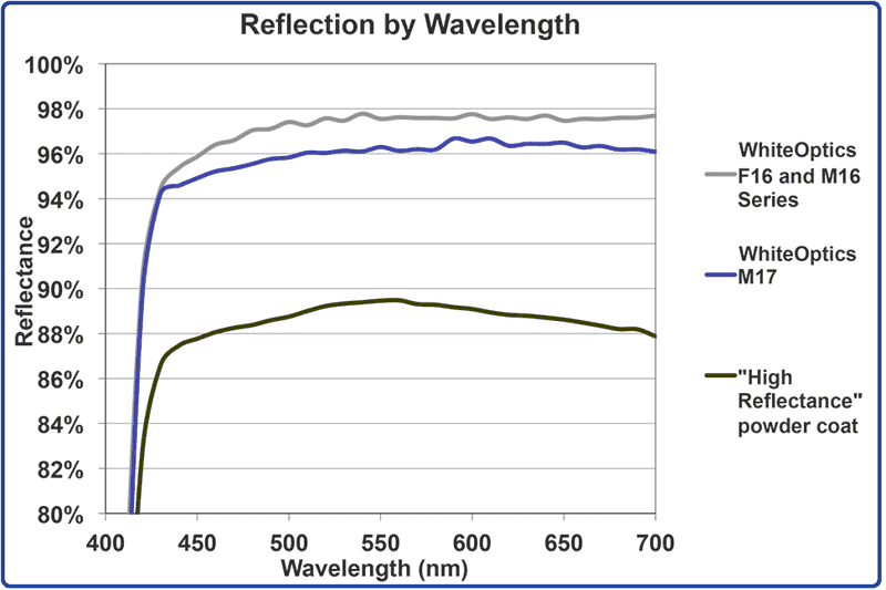

Next is coating everything not growing inside with reflective material, something like this http://whiteoptics.com/portfolio-item/technology-benefits/

Yes, just trying to strip what IR out I can without losing too much of the PAR 400-700nm wavelength.
A 'hot mirror' I've played with, got deal on 2' diameter edge chipped 'second', with dreams of positioning it on greenhouse wall with bank of heliostats all aiming at it like a bullseye, but wasn't cost effective when talking 100's of square feet worth of tracking heliostats.
NanoTint isn't cheap, but I'm also looking at their clear version that on single pass claims 87% VLT and 60% IR rejection. Double pass numbers through that then don't look too bad at 75% VLT. BTW, NanoTint is liquid, so it's not a filter that could be suspended elsewhere. I'd first thought about applying it directly to the poly film of the greenhouse itself, and while it might stop the IR there fine, it'd heat up that poly and then conduct a goodly portion of that heat inside defeating the purpose. An interference film coating applied there, though, reflecting, instead of absorbing, the IR, would be great, if it affordably exists to be had.
