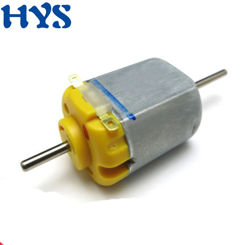

If I have a motor that is turning a shaft with only a small torque required but the shaft is also being forced into the motor, axially at a large force, what is the effect on the motor here?
If Faxial is large, does this effect T and how does this effect the motor?

If there is a large axial force, you need a thrust bearing to accommodate that force. I don't think many motors include a thrust bearing (I could be wrong), but if you use a motor with a "double shaft", you can put the thrust bearing on the end of the shaft that protrudes out the back of the motor...
https://ae01.alicdn.com/kf/H800cb6f513b9434c94ca5c1d24e0ee0et.jpg

The air gap torque is fixed by the magnetic circuit and is not affected by Faxial. Faxial is going to increase the friction in the thrust bearing and this in turn will reduce the available output torque of the motor.
