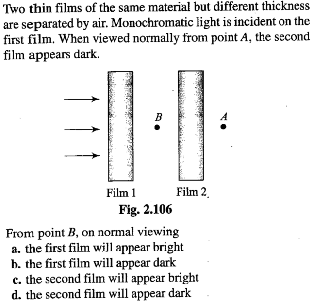

Two thin films of the same material but different thickness are separated by air. Monochromatic light is incident on the first film. When viewed normally from point A, the second film appears dark. On normal incidence, from point B:
a. the first film will appear bright
b. the first film will appear dark
c. the second film will appear bright
d. the second film will appear dark
Path difference due to thin film of thickness t and of refractive index μ is 2μt.
So, what I do not understand 1st and foremost is, when they say "see the film", does the light have to be reflected from the film or can I consider refraction of light through thin film also a case using which image can be formed? To be honest, I have solved this question before, but the problem is that I do not remember how to solve it anymore. I do not even know where to start. So please help me solve this problem again. Also, the answer is D.

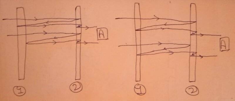

So I tried assuming the case where only reflection of light rays produces image.
Sorry for the clumsy ray diagram. But I satisfied the condition that film 2 should be dark for A. In 1 case, hard boundary occurs at film 1 and in the other case, film 2. But then how do I check for B? And is there any way that I can minimize the no. of reflections needed? Since I do not really remember doing this much last time.
This is a problem in logic. The films have different thicknesses which means that each film can produce either constructive of destructive interference upon reflection in which case the transmission through each will be, respectively, destructive or constructive. We assume no in-between interference.
Does this help?
Could you answer this part of my doubt as well? eg. If the light rays pass through both the films without reflection and reach A, does A see film 1 or 2 or both? Or does he even see an image? I think he can not see either film. Am I right?
It's not a matter of images. You don't "see" light if light does not reach point A. Conversely, if light reaches point A, you "see" it. Here, we are told that light does not reach point A. It's like placing an opaque screen at the location of Film 2.

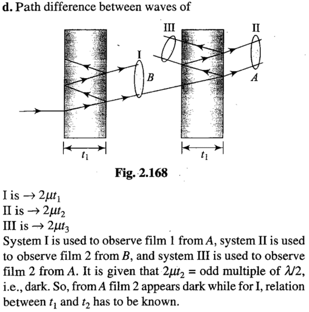

Here is the the solution given in the book.
I have understood absolutely nothing of this solution. Please help me understand it if it made sense to you. And sure, if no one here solves it, I will figure it out and explain it here.

What makes it tough is the typos.
The diagram labels the right hand thickness ##t_1## instead of ##t_2##.
The text following it has A and B swapped over.
##t_3## should be ##t_2##,
That said, I find the conclusion difficult to believe. It implies the right hand film is absorbing much of the light. I need to think about it more.

We never see the film; we see the light that passes through it. Ignore Film 2 for the time being and look at Film 1. Imagine one observer to the right of the film at B and another observer to the left of th film at, say, C. If observer B sees light (constructive interference), observer C will see dark. That's because of the phase shift by π upon reflection between air and dielectric on the left side of Film 1. No such phase shift occurs for the light that is refracted straight through and the light that is reflected an even number of times within the film. We have to assume that we have constructive interference if we combine at B what emerges from Film 1. Without this assumption, we have the trivial result that no light passes through Film 1 to reach Film 2.
Now let's look at Film 2. We are told that it is dark, which means that no light makes it through, i.e. destructive interference at "system II" at A where the refracted and double reflected rays are combined. Thus, the phase difference between rays that reach II is an odd multiple of π. The question is what happens at B when the reflected rays from that film are combined at "system III"?
Well, I think the diagram shown in the solution is flawed because it shows the interference of reflected rays from the right interface of Film 2, all of which differ by even multiples of π. It shoud show instead the interference between the multiply reflected rays at the right interface and the reflected rays at the left interface which differ by odd multiples of π. That's because of the additional phase shift by π at the left interface of Film 2. This means constructive interference at "system III".
To summarize, I think that, relative to the phase of the monochromatic source,
  1. the phase of the light at "system I" is an even multiple of π
  2. the phase of the light at "system II" is an odd multiple of π
  3. the phase of the light at "system III" is an even multiple of π.
So now how does one answer the question? In the region between the films we have transmitted rays from Film 1 traveling to the right and reflected rays from Film 2 traveling to the left. Their phases differ by even multiples of π which means constructive interference. If I plant myself in the region between films and look either way, I will see monochromatic light coming from each filter.
If this is a multiple choice question, the correct answer is "None of the above, both films are bright." If this is a multiple answer question the correct answer is "a and c". I know I may be stretching this a bit, but it's the only way I see to make sense of this question.

Of particular interest is the last link that provides a rationale for answer (d). Here is the logic
  1. Because no light reaches point A, there must be destructive interference at either Film 1 or Film 2.
  2. If this destructive interference occurs at Film 1, then Film 2 will receive no light and therefore appear dark from point B.
  3. If this destructive interference occurs at Film 2, then Film 2 will still appear dark from point B.
Argument 2 is fine. Argument 3 is specious. Film 2 is not a black hole.

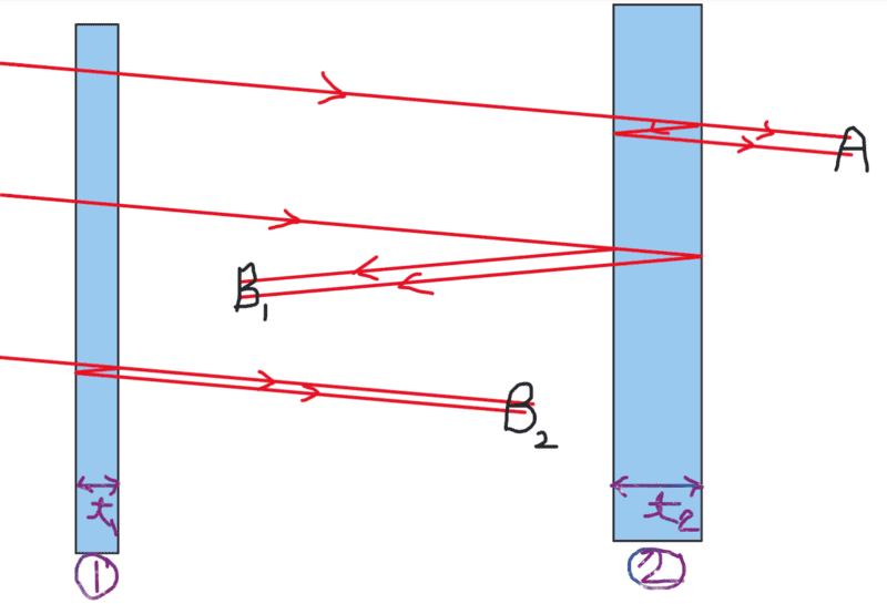

I think I get what you mean, but I would personally rather believe that the problem is correct but I am not able to solve it, atleast as of now. I will keep your point about phase change of waves in mind. Also, could you give an example of a soap bubble problem? Thank you.
I request that we all use this diagram as convention from now. The previous one is just stupid. By the way, I think I might have a solution.
From the POV of A, the path difference is 2μt₂. Since there is no phase change of π anywhere, the conditions for maxima and minima do not change. So, since A does not see 2nd film, The path difference is an odd multiple of λ/2. Hence, 2μt₂ = (n-½)λ.
From the POV of B₁ again, the path difference is 2μt₂. But here, since a phase change of π occurs, the conditions for maxima and minima interchange. So, now, the condition for maxima is for the path difference to be an odd multiple of λ/2. So, from the above conclusion 2μt₂ = (n-½)λ, B₁ is able to see the 2nd film clearly.
As for B₂, since we no information about t₁, we can not conclude anything about the path difference and hence the 1st film can be either seen or unseen for B₂.
What do you guys think about this, I might not be getting the correct answer, but this is the closest I have gotten to solve this problem.

Actually, the diagram is post #15 is not appropriate for analyzing the situation correctly. The picture below shows the five regions in space where there are EM waves. In regions I and V you have, respectively, the incident and transmitted waves traveling to the right. In the other three regions you have waves traveling to the left (red) and to the right (black). This becomes a problem of matching boundary conditions at the four interfaces sorting out the wave amplitude in each region. The solution is facilitated with the transfer matrix method. That said, I am sure the author of the problem did not intend it to be this complicated. I am mentioning this because you need to understand that, in region III between films, there is only one wave traveling to the right and only on traveling to the left.

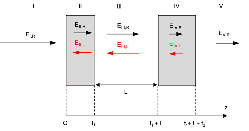

haruspex said:
https://en.wikipedia.org/wiki/Transfer-matrix_method_(optics)
I don’t expect you to understand that text (I wish I could) but it demonstrates that the book solution is simplistic. The topic is too advanced for the author.

The analysis in post #15 has two problems, in my view.
First, it arbitrarily stops after two rays headed towards the viewer. In reality, there is an infinite sequence of internal reflections, leading to an infinite sequence of paths to the viewer.
Secondly, it fails to consider the relative strengths of the paths. A reflection in going from ##n_1## to ##n_2## may be a different fraction of the intensity than the reverse case; the second rightwards ray leaving the film will be weaker than the first.
The matrix transfer method deals with these complexities by treating it all as a single waveform.
At least your analysis does not lead to an obvious fallacy, so may well be a reasonable approximation to what happens in some cases. That does not mean it will be approximately right in all cases.
A simpler and safer argument is to note that, assuming it absorbs nothing, all the light entering the second film has to come out some time. Since we are told it looks dark from the right it must look bright from the left.
